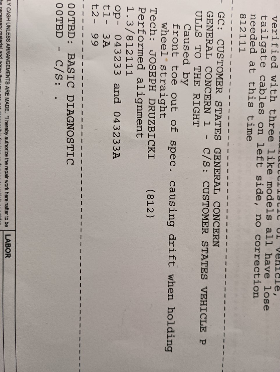

    400 miles on my 2023. Just went in for an alignment at dealer. They did it and said my toe was off a little bit. Got truck back. Drives the same and "drifts" right. Not the crown as It does it in level parking lots too. I have to hold the wheel slightly to the left to stay straight on roads. Any advice? Sat at the dealer for 5 hours for them to do it only to have the truck drive the same. Obviously bring it back but what else could it be

    #350088

    I’d go with the tech as the problem. It could be a bad tire I guess. Have the service advisor or lead mechanic take it for a quick test drive.

    Did you get the spec sheet after the alignment? I usually try to get all the documentation I can for my truck as I have a binder it all goes into.

    The term “pulling” means to me that you let go of the steering wheel on flat ground and the automobile steers one way or the other. The root cause is often a suspension alignment issue.
    I think what you are describing is that the steering wheel is not perfectly aligned when driving straight. This is a lesser issue that can be remedied by adjusting the steering box and/or tie rods. I don’t think it’s a standard task preformed by alignment shops.
    Personally I’ve rarely ever had an automobile with a perfected aligned steering wheel and it doesn’t bother me. Pulling on the other hand can be very annoying to me.

    Post your printout. An alignment will only cause a pull if your caster is 1 degree or more left to right. It will pull to the low side. In this case your right caster would need to be a full degree lower. There are a few other things that can cause a pull. Air pressure would be the first check. Then cross rotate the front tires.

    If the wheel is in the center it goes to the right, on highway, non highway, parking lots etc. I have to hold the wheel to the left to stay straight anytime I drive it. They never gave me the numbers just this paper.
    This is how far i have to hold the wheel to the left to go straight.

    That sheet they gave is not helpful at all. You really need to see the numbers, and more specifically, the caster numbers. Unless your toe was way way out it won't cause a pull but lower caster on the passenger than the driver's side will. I would go to a dedicated alignment shop that knows how to diagnose and more importantly, which end of the specs to set your truck to and report back with their printout.
