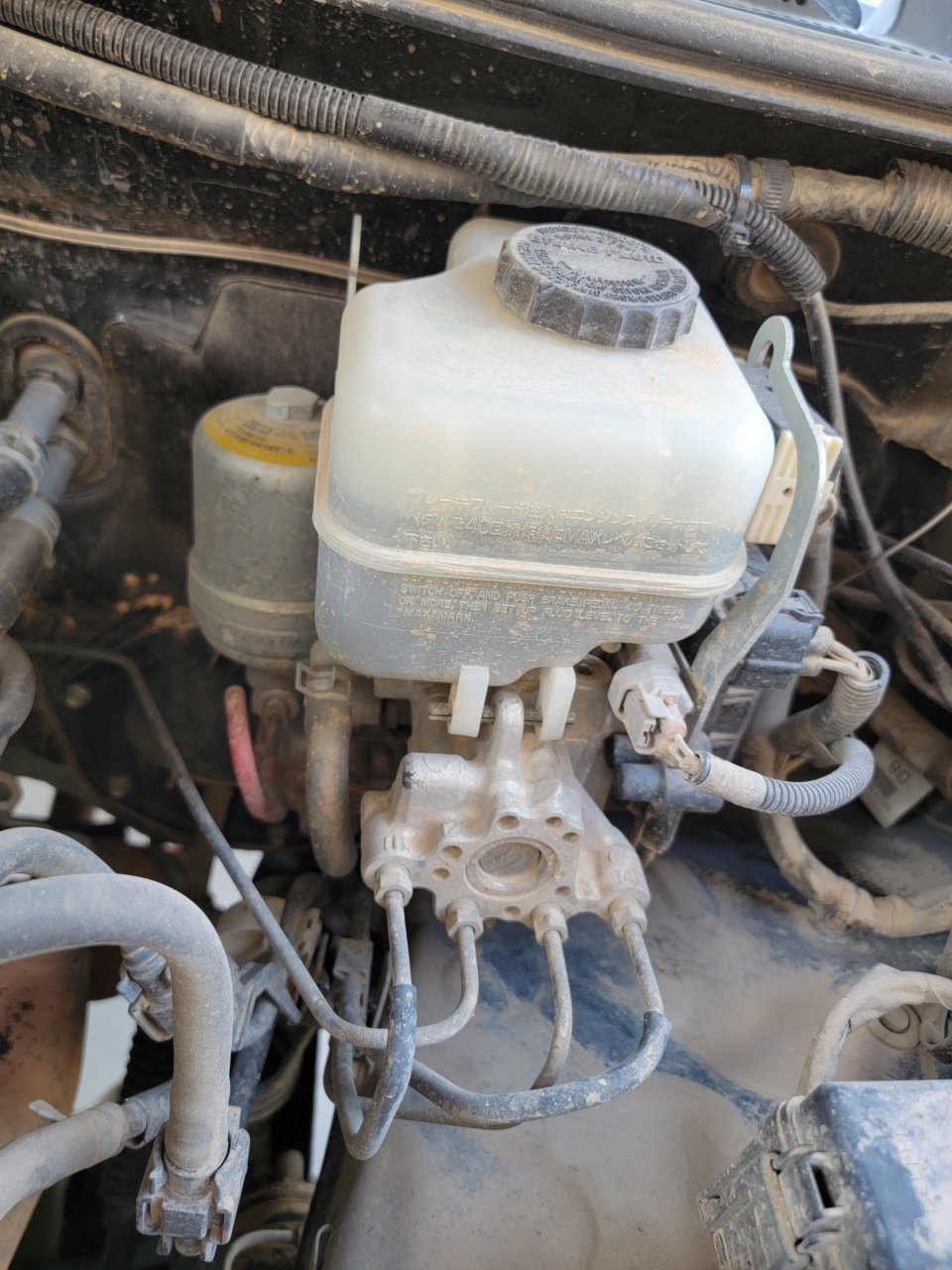

    Ok so I've got some serious whistling coming from my brakes. It's only on the driver's side, not a rock in the rotor or anything. Probably the electro booster or something.
    It's a loud whistle only at the very beginning of pushing the pedal. Once fully pushed it goes away. It also happens intermittently, during extra use, and not every time I brake. Super loud though. I have a TRD OR 4x4, so I have the electronic hydraulic booster, not the typical vacuum booster that many here have.
    No fluid in the cab by the pedal. Can't see any leaks. Going to check the hoses this afternoon but figured I'd post for input. Any ideas?

    The OP indicates that he has a TRD OR and as such likely has the electro-hydraulic version of the brake booster verses the more traditional vacuum assist type. The electro-hydraulic type has a high pressure pump driven accumulator and master cylinder solenoid(s) with an integral ECU.
    This type of booster can make all kinds of noise, especially during repeated braking and other failure creating rapid pressure depletion in the accumulator, pump problems and I suspect internal leaks can also make noises. On mine, sometimes I get a high-pitch motor-like whine that can go on for considerable time.
    I have been chasing a possible failure code on my '14. I ordered a complete new unit but have not had the opportunity to swap it out yet.
    OP, mine has never triggered a CEL but I do get a periodic code displayed for low pressure in the accumulator when viewed using the techstream.
    You may also want to dig around in the 4Runner forums as I believe there have been a number of failures on earlier generations that use the same type of setup for stability control and ATRAC operations.

    Yeah, I do my own brakes. It doesn't sound like pads squeaking I've ever heard. I checked the clips, rivets, and shims visually, and everything seems fine. I'm going to pull the wheel off tonight and take the pads out to double-check, I just needed to go get more grease for reinstalling everything. It's stock rotors and power stop pads.
    So I have the 2011 TRD OR, and it looks like it's electronically boosted and I don't have the big round rubber booster that others do. Or I'm confused. And the hissing is only sometimes, very intermittent, and when I push more than a tiny bit the sounds completely goes away. It's only the first 15-20% of pedal push.
    And yes, yes I know. It needs a good cleaning under here. I offroad often, in Vegas, in a lot of dust.

    You are right. I do not have a typical booster. It's an electro-assist system. See my image in the post above. I don't have a CEL or anything.
