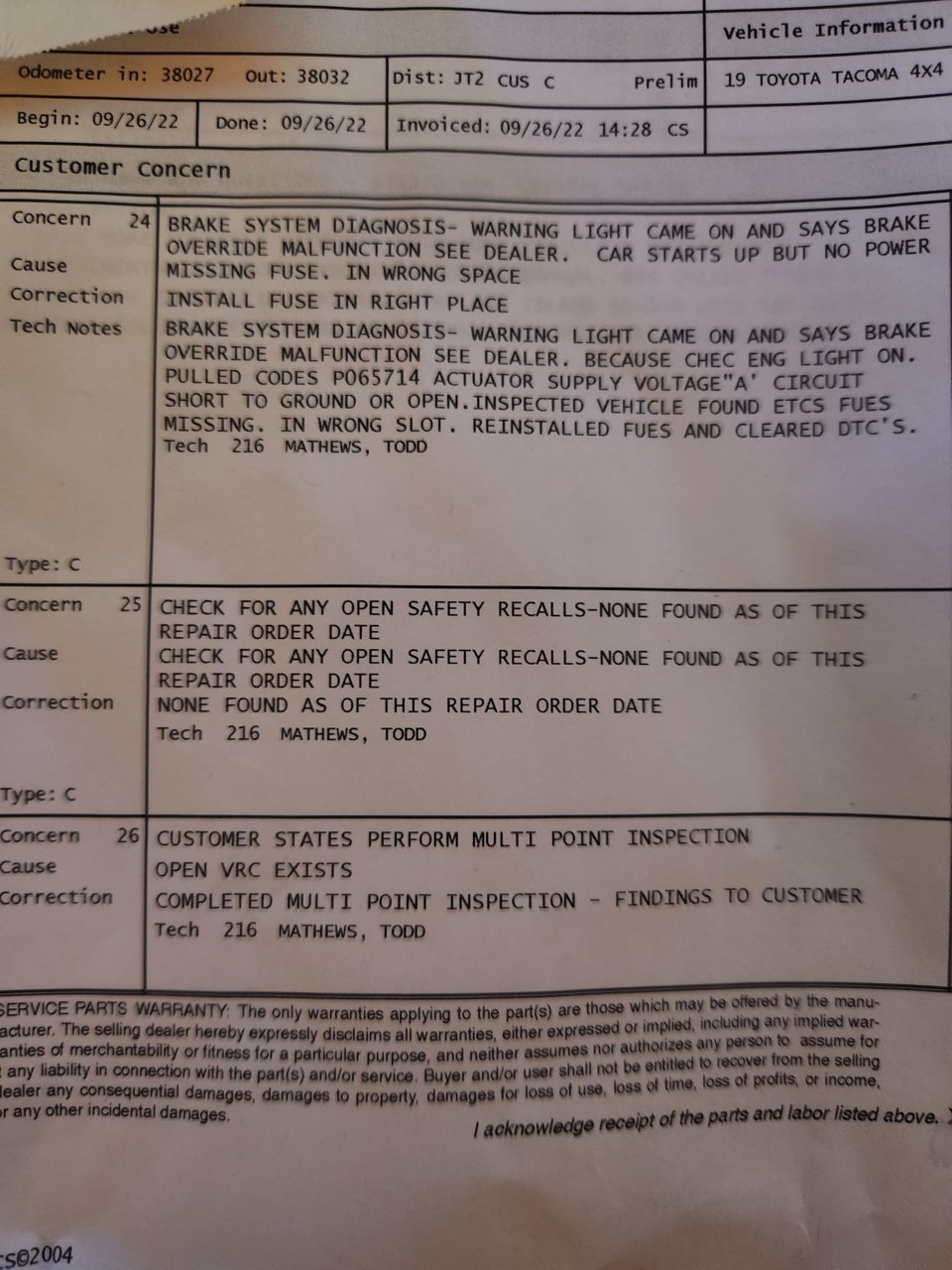

    I had a brake override malfunction warning on my dash. Truck in limp mode. Checked the stop fuse and it was good. Had truck towed to Kona Toyota and they said the cause was etcs fuse in the wrong place. So they supposedly moved the existing fuse that was in the wrong place and also charged me another $14 for another fuse which wasn't needed. $161.26 total with labor. I am thinking they are making stuff up to get me to pay the diagnostic fee and not have the warranty cover it. How the hell can the truck be running fine the past 3 1/2 years with the fuse on the wrong spot? Mods are pod lights and alpine stereo and speakers installed over 3 years ago. Bottom line is the truck ran fine, then broke, and I had it towed. Kona Toyota is a scam dealership.

    Maybe just maybe when you checked the fuse it was placed back on a different spot .

    Yes I thought that too but I only checked the stop fuse after reading this forum. I never checked the etcs fuse. Also how would the truck be running before if the fuse was in the wrong spot? Don't know.

    My friend figured it out. There was water in my third brakelight and the connection was all corroded but the light was still working. Cleaned and dried it and no problems after. I had the Recall done already but I guess it leaked. Funny before the recall fix didn't have any problems.
