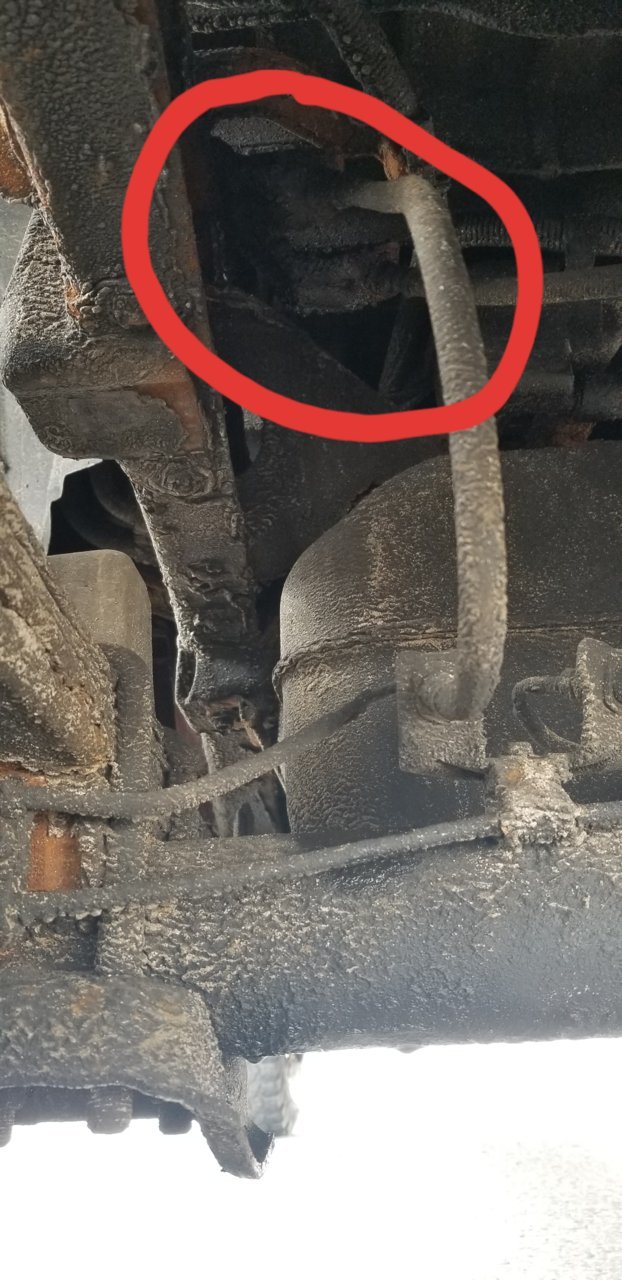

    Hey Everyone!
    This is my first post here and I'm just looking for some help. I got a 2007 AC 4.0 back in October and for about a month now I've been slowly losing brake fluid. I found the leak and it appears to be above the rear axle drivers side (ref pictures) where there's a brake line connection. Not sure if anyone's had a similar problem and could provide me some guidance.
    I like too wrench on stuff myself and would rather do it than taking it to a shop but most of my experience is from my old subie (headgaskets, clutch, etc). I also checked around the forums but couldn't find anything similar. I'm not really super familiar with brake line systems so any advice to give me a place to start would be greatly appreciated!

    Well lets put it this way more than likely the steel line where ever it goes and a flex hose you'll never get either one off in one piece.

    Yep.
    Crusty brake lines can be a huge PITA to work on.... sometimes it's worth paying the professionals, if only to avoid the frustration and anger sharks.
    The lower bracket and hard lines don't look too bad. Here are the part numbers you'll likely need to R&R. Fingers crossed the forward connections come off without issue.

    That is super helpful really appreciate the reply. Yea sadly up here in Canada everything rusts so hopefully it'll come apart.

    I'll give you a hint is there is some thing in there you would like to save you will never get a wrench to turn the steel brake line nut free. Just cut it close to the nut and use a 6 point socket to try an remove it from the fitting. I live in Maine and used to work in a local garage and rusted stuff was common place not just break lines. Once you have it all back together FF the snot out of it.

    Yea so it looks like it's just the one steel line is leaking right behind the connection so guess ill go ahead and replace the whole line. And thanks @maineah ill do that when I attempt to remove the steel line that's a great tip. Would you guys recommend using OEM lines or some aftermarket stuff and bend and flair myself?

    Sorry to say but I would question the overall condition of the frame
    From what I see it does not look good
    Good luck with the brakes thou

    It is a double flair you will need a proper tool it would be easier to use a longer line and just put a loop in it. there is a cheap bending tool better that then by hand to avoid kinking it

    It's actually pretty clean for the area and all the salt they put down around here. Been oil sprayed yearly since new that's really the only spot where it shows some rust.

    yea ok probably cheaper for me to just grab the OEM lines than buy the tools to flair and bend aftermarket ones

    Wouldnt you know it .
    Lost my brake pedal the other day dammit .
    My brake line is leaking in the same darn spot as this !!!!!!! Golly
    The frame is fine as I have a case of grease smushed all over it .
    Living in the salt belt sucks .
    Time to look for a new Toyota

    hopefully it’s just the line. Normal not a big deal. Kind of hard to break free and not strip
    actual hardline and flared fitting, that would be more difficult

    The line coming to the first bracket above the axle id clean the area as best I could and put a little heat to it with a vice grips, if she twists the hard line, then just buy a little bit of line and make a poop like maineah said.. you’ll never snake the factory lines along the frame with the body on

    Yah
    No kidding.
    All the brake lines are deep above the gas tank .
    I just grabbed some metric line and a couple union's from the auto supplier .
    Will see how this goes shortly .
    May have to get the torch out .
