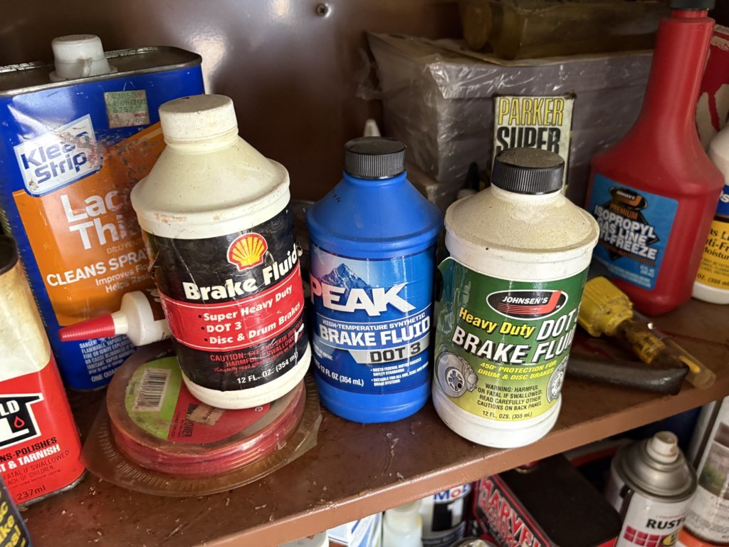

    My 2017 Taco says I can used DOT 3 or 4 brake fluid. I have 3 on the shelf but will use 4 if better and what was OEM. Any opinions?
    Thanks

    If the DOT 3 on your shelf is unopened, then go ahead and use it, otherwise maybe this will help you decide:
