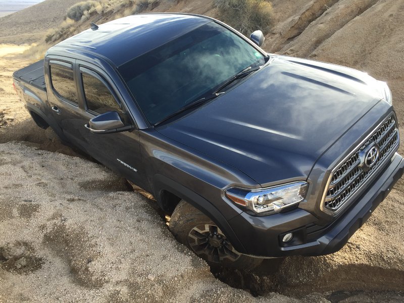

    The first time that I used CC I was stuck in a ditch. 2016-01-06 10.14.44.jpg
    After running the system for 2-3 minutes the tranny overheated and I shut it down. After letting it cool back down, I tried CC one more time and popped it out of the hole. I liked how it got me un-stuck without so much as me shoveling one grain of dirt. Later, when I got back to pavement though, I could tell right away that the drums were warped and knew that it had to be from the above incident. This is when the dealership turned the rotors for me. I've used CC a few times since then, once to get up a 100' steep, sandy hill. I only used it this time for 20-30 seconds top. There were no issues after this use. Most recently I've used it to go down some moderately steep inclines that were a little to steep for 4-low 1st gear with a distance of, I'd guess, no more than 300'-400'. The CC wasn't working very hard either. Since then though, I've noticed a more subtle shake when braking. I'd thought that maybe it was the rough streets that I drive on. When I looked it up in the owners manual, it doesn't specify a specific length of time, but is very vague and says "If CC is used continuously for a long time". I'd like to know what Toyota considers a long time. So far I'm partially impressed with the system. It's gotten through a couple tough obstacles, but it's also causing some reliability issues. I really wanted a standard transmission, but went with the auto because of the CC. Now I wonder if I didn't make a mistake. What do you guys think?
