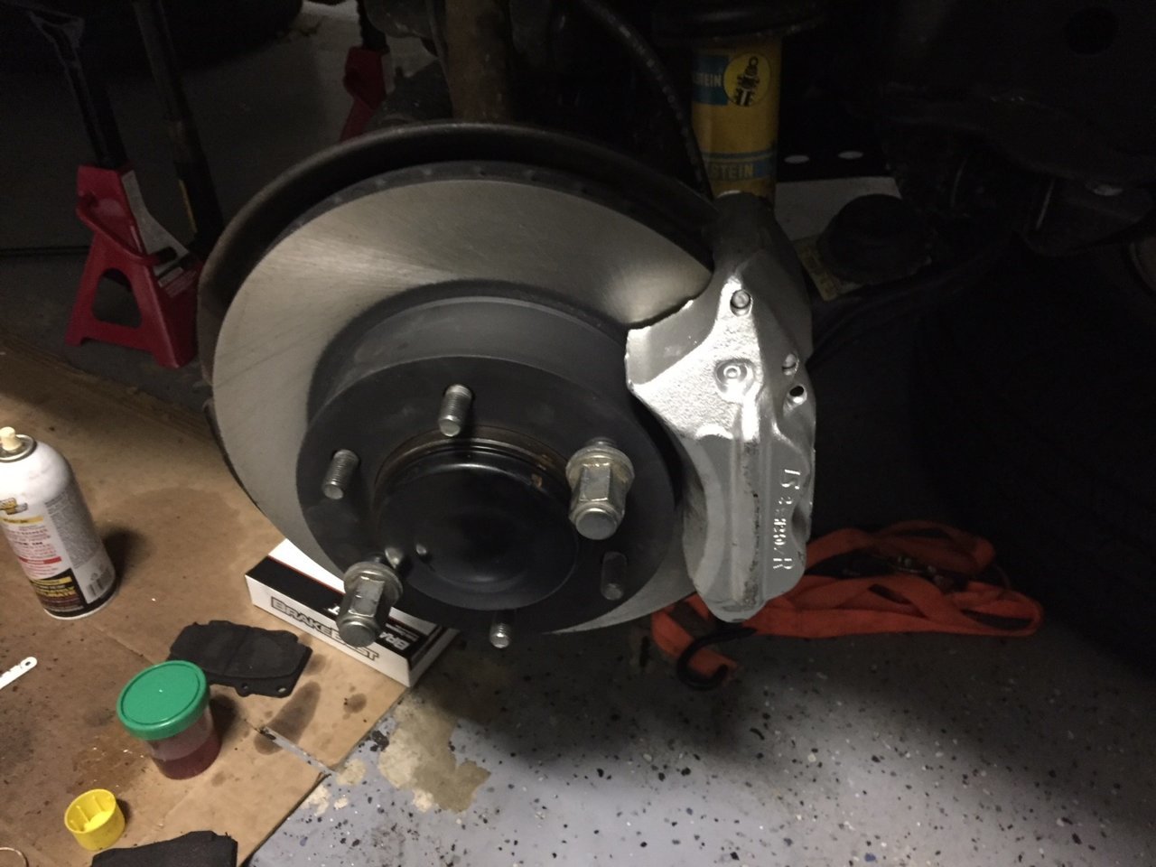

  9. Feb 26, 2019 at 8:07 PM
    Ship_wreck_d
    Ship_wreck_d New Member
    Jan 25, 2018
    #242388
    2012 Tacoma SR5 4X4 Access Cab
    Bull Bar
    I went to change my pads out today, before my state inspection was due, simple I thought, but of course many mysteries awaited. I ran into the same issue, used heat, sledge w/punch, no joy. I was about to give in and take it to a local garage, and figured, I've been wanting to get nice, pretty gunmetal looking calipers anyway, so I decided to just replace both calipers, they were pretty well rusted out, albeit functional, for now.

    yeah that is what I ended up doing -
