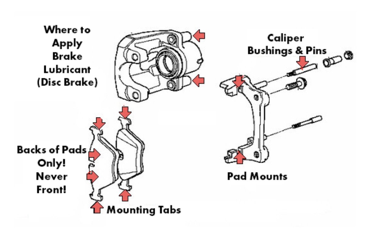

    OK, went outside to look at the caliper and watched a few videos on the topic. Are you just refering to applying the grease to the pins the brake pads slide on? I lube those up when I change the brake pads. I am not sure how you could access the caliper piston boots properly without removing the brake pads and most likely unbolting the caliper so the rotor isn't in the way.

    Putting grease on the boots as a preventative maintenance is some kind of cockamamie BS. Don’t do it.

    Yeah, I agree. Thought for a minute that I had missed a key maintenance item, but even if applying grease to the boots would help (not sure it would), you can't get at the piston boot without pulling off the caliper and removing the pads. I think the reference was to greasing the slide pins.

    Just this, I might have accidentally said piston earlier when I mean the pins.upload_2019-12-15_7-1-51.jpg
