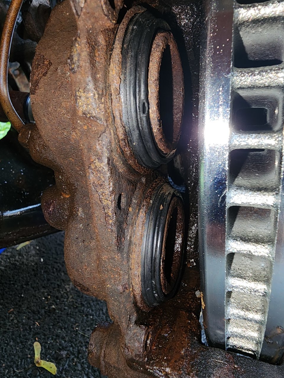

    Replacing brake pads on front passenger side. One side of the pistons are stuck and will not go in. I am unable to fit the pad in. Is the caliper broke? Should I replace it or is there a way to get it unstuck?

    Happend to me when i did my last break job. You need a new caliper. I just went to orileys auto parts and got one then ordered an OE later.

    It’s done….while you might unstick it, there is corrosion in the bore that’s grabbing onto the piston.
    beware of reman calipers…they’re mostly garbage…you won’t get much life out of ‘em….the cleaning process usually destroys the pistons, and they start rusting in short order. Don’t buy powder coated calipers either…all the surfaces that need to be protected are masked off and have no coating:
    get new plated calipers…if you can’t find any local, we have them available

    So I broke what I think is the brake line as I was taking the caliper off. What do I do now?

    Buy a new one

    That rust is atrocious.

    Gotta love upstate NY winters

    The way the top right corner looks rounded off, and the top left is still square, I'll bet ya didn't use a line wrench.

    Line wrench won't help with all that rust, that's pretty bad. The nut actually looks fine, the line only snapped because the fitting wouldn't spin around it when loosened. It's unfortunate and frankly he didn't really have much choice
    Normal "rules" of auto repair don't apply when metal isn't even metal anymore. I can't even begin to imagine being a tech in the rust belt
