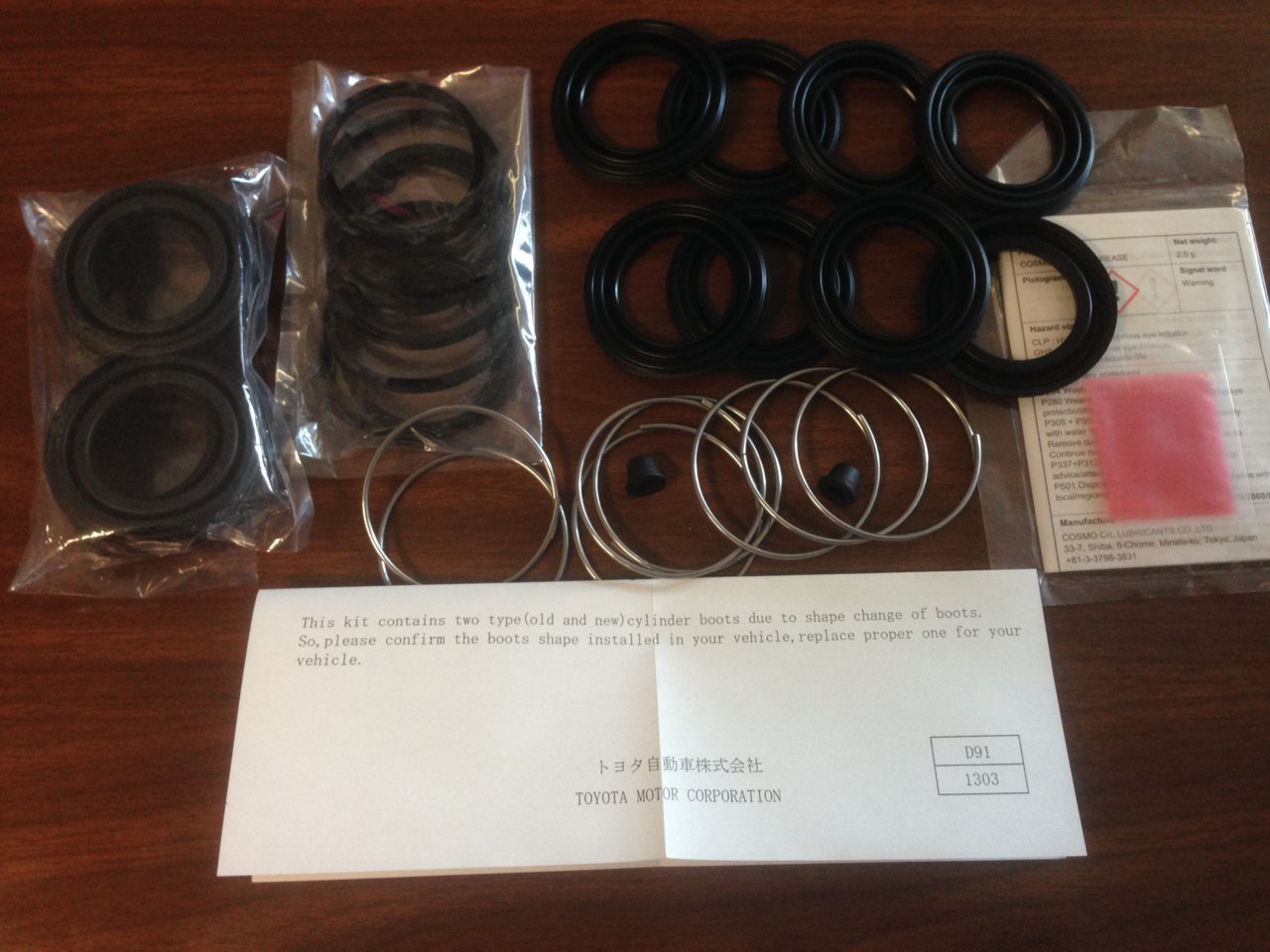

    The new caliper seals and boots are only about $20 from Toyota for enough to do both sides. Be sure to take your VIN number with you because there was a design change mid way through 2006. IMG_2130.jpg

    I have a 2015 Tacoma. I noticed when I changed my breaks that one of the dust boot covers on the piston were torn. You can buy these at the Toyota dealership for 20 bucks. It comes with the gasket seal, the dust boot covers, and the retaining metal clip for the dust boot cover. To just change the dust boot cover you do not need to replace the caliper, or remove the piston. If the caliper is functioning properly, just replace the dust boot. It was a simple job, didn’t even remove the caliper from the truck.

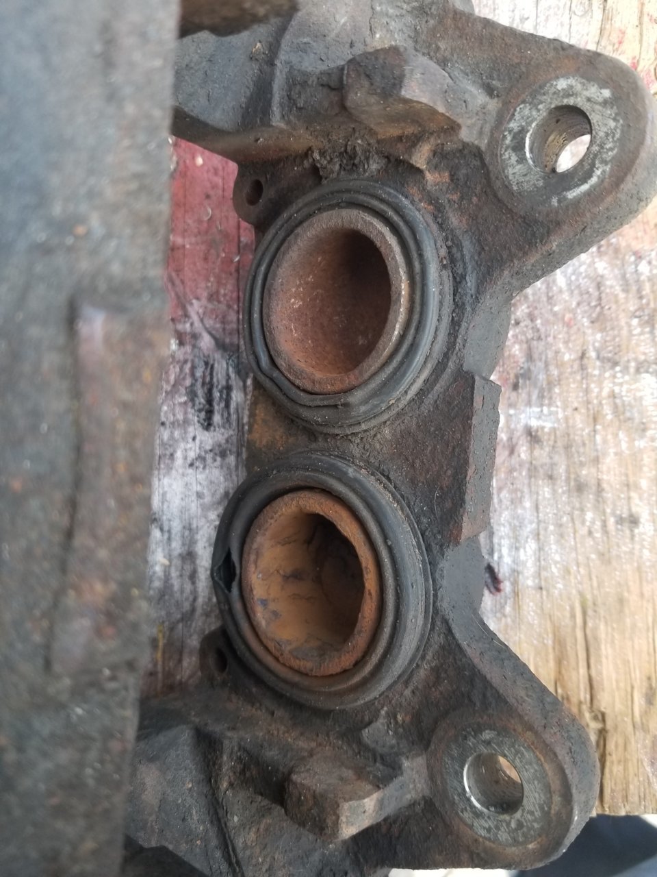

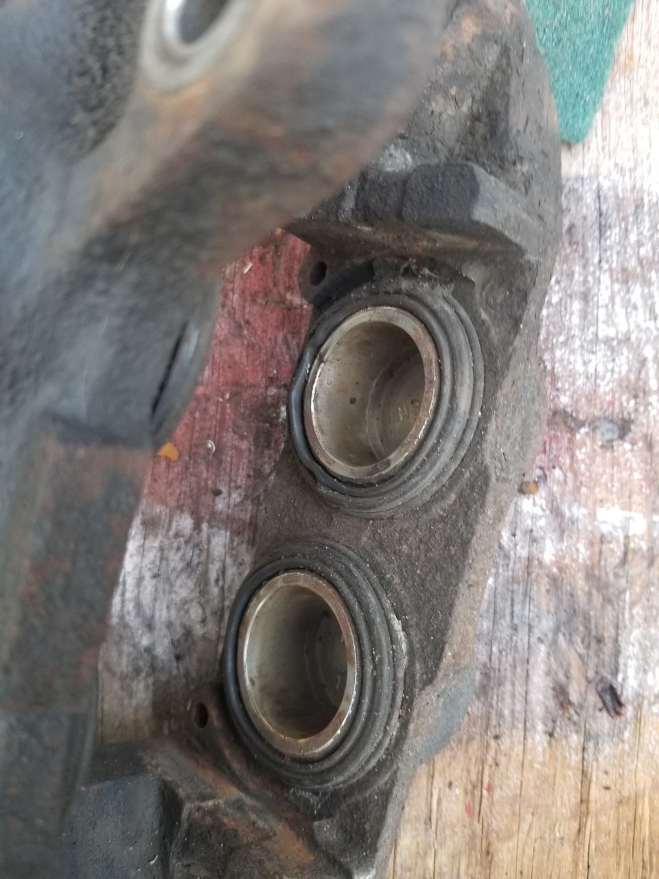

    I replaced my calipers last fall after 10 years of service. I noticed the dust seals on the pistons (only the pistons on the side of the caliper closet to the engine) where torn. In the pics below, the inside of the piston cups are rusty on the side where the boots failed. I am going to add replacing the boots to preventative maintenance list and do every few years whether it needs it or not. 20201129_135732.jpg 20201129_135739.jpg
    Did you just remove the pads and then replace the boots? Any tricks to this or just a matter of just popping off the retaining ring, remove boot, and replace with new boot and ring?

    Anyone know the part number for this kit? Apparently it comes with both types of dust boot. I'm thinking of having a spare set on hand, maybe change them in a few years before they dry out.

    For anybody in the future that's unsure about fixing a torn boot vs getting a new caliper, just fix the boot. It's one of the easier maintenance items I've ever done. 04478-04050 is the correct PN. That includes 8x boots and attachment rings as well as bleeder valve covers and some grease. $20 and it was to my dealers parts dept the morning after I ordered it. Same stuff for 3rd gen.
