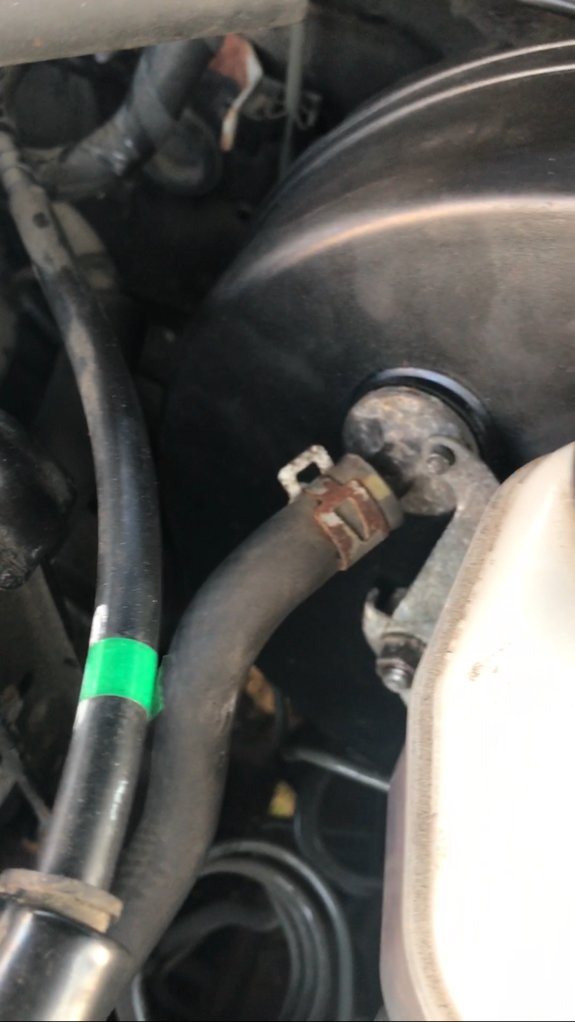

    hey everyone I just replaced my brake booster, now my brake pedal is very stiff and there's a whistle coming from the brake booster. I checked all the hoses and sprayed soapy water in them and couldn't find a leak. Has anyone had this happen before or have any advice? The video won't upload but here's a few pics of the new one installed

    if there is no vacuum assist the booster in not functioning... the whistle is the vacuum leak from the diaphram that is tore. A good booster should hold enough vacuum for maybe 2 full brake applications before it gets firm. Squeeze the vacuum line that goes to the intake and see if the idle speed improves and drops, if so, the booster is not holding.

    Ok I'll check that tomorrow. Just to be sure, the vacuum line is the line in the second pic correct? I'm Pretty new to doing it yourself and this was my first project so I'm still trying to learn everything

    Yes. This should help you visualize what is happening or should be happening inside when it's working.

    So I squeezed that hose today. The engine didn't rev up or down but as soon as I squeezed the hose the whistle went away. Any ideas?

    the metal bit that the hose connects to is a check valve.

    It looks likes it seated good and I've sprayed soot water all around it and it doesn't seem to be leaking. As much as I would hate to take that thing back out again is it possible I just got a bad brake booster?

    Actually spraying soapy water will not help with detecting vacuum leak. Bubbles would form inside the leaking part and you will not be able to see it. So if you hit a leaking place with soapy water the only thing you did was adding some water to the guts of the booster.
    If your booster is whistling and not working it has a leak. Not necessary big leak causing air bypass increasing the rpm but it is enough to stop booster from keeping a vacuum and playing a flute. If you can't see from the outside any visible hole my guess is to take it out and then check for leaks or improper operation. I don;t know if applying a slight pressure instead of vacuum to the booster would cause some damages. If not you may try apply a slight air pressure to the buster and then check with soapy water. But again I DO NOT KNOW IF PRESSURE WILL NOT DAMAGE THE BOOSTER.

    If you pinch that hose and the noise stops AND you have confirmed that the plastic check valve is sealed and not itself leaking (including the hose connection to it), better break out those tools because the booster is bad. Sucks. I've replaced probably 25 boosters and thankfully never had a bad new part. How crappy was the process? Some are easy and some...

    when you have the booster out examine the master cylinder to booster seal. It is round and fits down inside the bore that the master cylinder slides into. There is a possibility of tearing this seal also when you reinstall the master cylinder especially when you leave the brake lines attached to the master cylinder and wrestle it out of the way.

    Well I feel stupid now, it's that inside seal. The new one didn't come with any seals. I had to call a Toyota dealership to get the paper seal between the master cylinder and brake booster and he told me I didn't need one for the back of the brake booster so once I got everything apart I figured the inside was the same.
