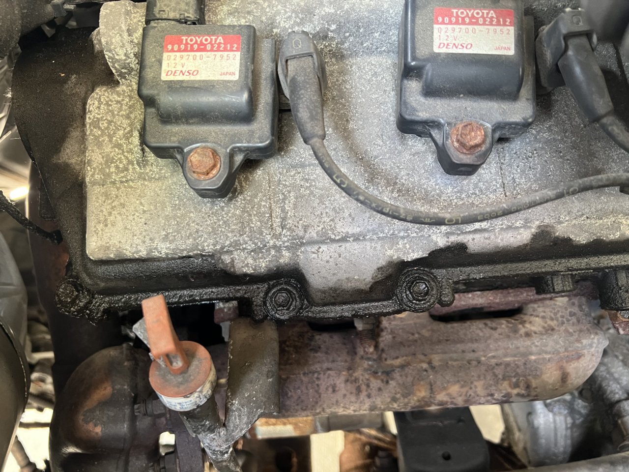

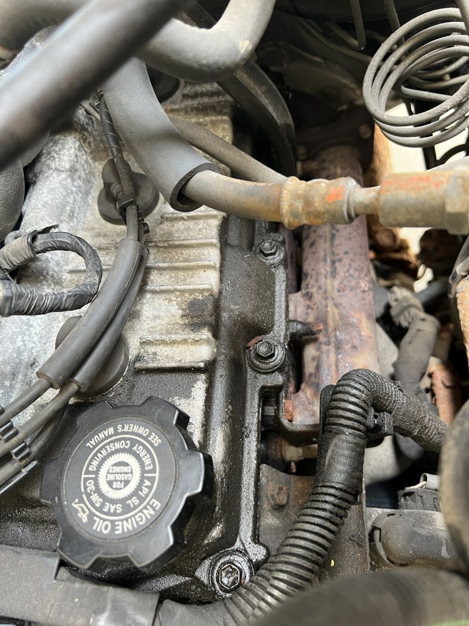

    4B2B6361-2E58-43D4-8DBD-C9652EE32FEB.jpg Finished by valve cover gasket replacement and replaced vacuum lines too. Everything went well except when putting one of the valve cover bolts back in the head snapped off luckily I was able to take the valve cover again and take it out with no issues.
    Before this I was kept getting a ‘O2 sensor circuit Bank 1 Sensor 2’ check engine light and I assumed this was because some oil was burning due to the old gasket. After I replaced it the issue happened less often on a 750 mile road trip I took but it was still there. After the road trip I replaced the vacuum lines and the issue hasn’t come back yet so I hope it’s solved.
    Before and after pictures attached.

    I had that happen on my 3rz last month. One dang bolt. I had to drill and re-tap the hole.
    Your engine bay looks good
