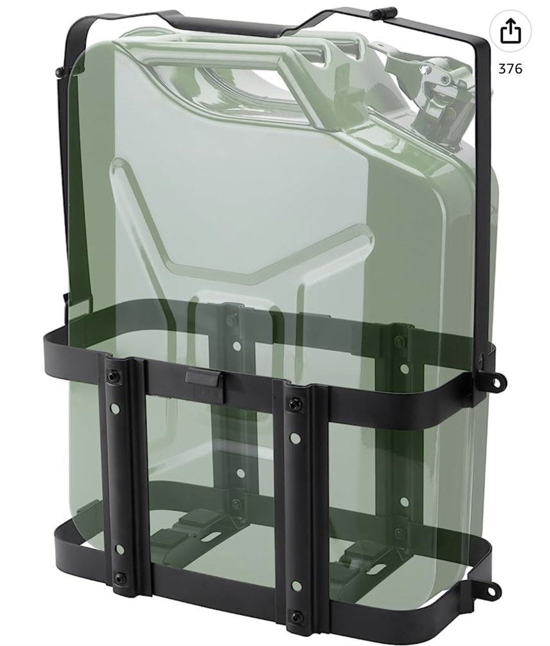

    Came home from a day of bumpy off-roading with a sagging Jerry Can about to fall off the back of my truck! I bought a strap style can holder and it was mounted by the four holes on one of the sides. It bent outwards when I had my 6 gallon can in it on a fairly potholed and rutted road for 20 miles.
    I think this style would only work when also supported on the bottom. It’s clearly not for hanging cans with no bottom support.

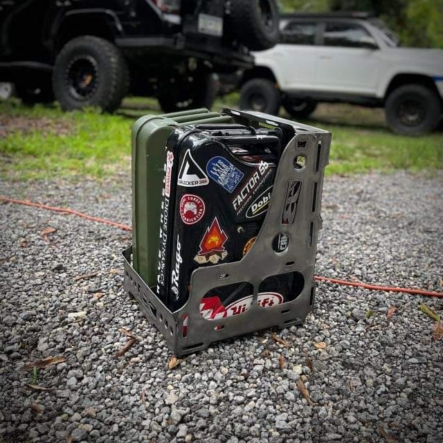

    How did your cans mount up before? I recently just got a dual can holder from Chad over at BashFab. Need to get it powder costed but I loved that they were set up for multiple mounting styles.

    I bought this style can holder and it was mounted by the four holes on one of the sides. It bent outwards from the top corners which are not supported to the mount, allowing the can to lean outwards.
    I think this style will really only work when also supported on the bottom. It’s clearly not for hanging cans with no bottom support.
