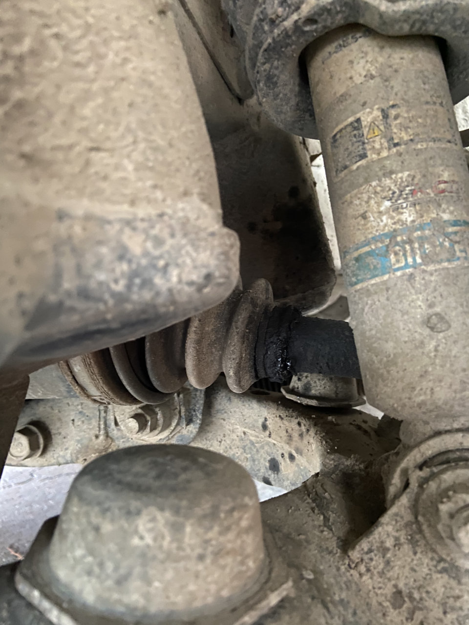

    Those look like aftermarket/parts store axles I'm assuming? Since the shaft isn't green or blue like OEM ones
    The parts store axles use a boot material that sucks pretty bad, I've blown quite a few of them even when they weren't rubbing. Road debris would knick them easily

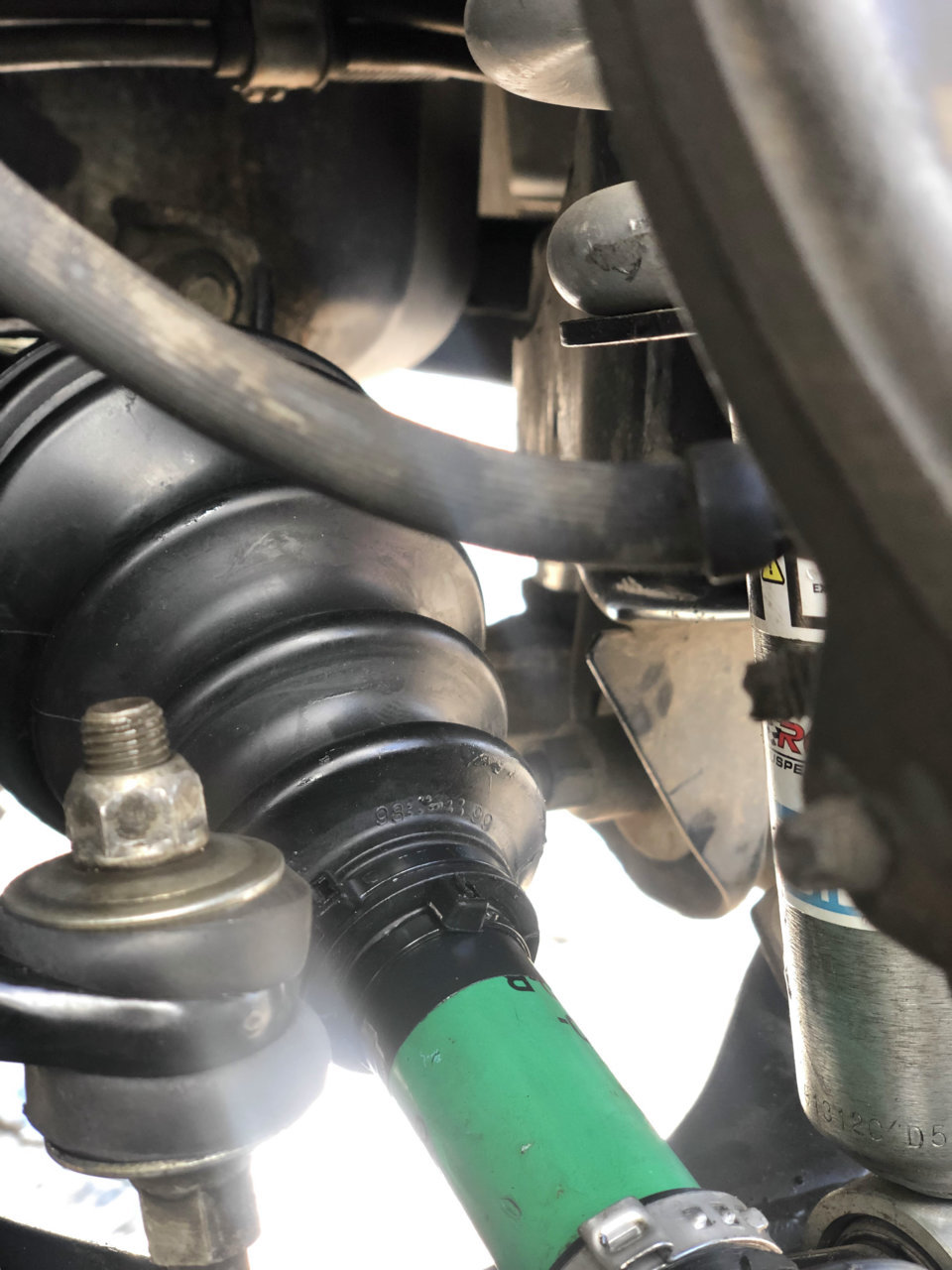

    Nah I only run OEM's. That color you don't see is because of that that thing in the NE we like to call "rust" :p
    So far the magical combination that always worked for me was OEM outer boots, SDHQ inners.
    This kit to be exact for the inners:
    https://sdhqoffroad.com/collections...placement-cv-boot-kits?variant=12249935740963
    But looking at that CV's that might be an OEM axle I never did the slide mod on. I never had issues until I got the coilovers with more droop. At this point I can't keep track of what are my used OEM's I did the slide on or didn't do it on. I do have a parts store axle in my OSK but never put it anywhere near the truck yet.

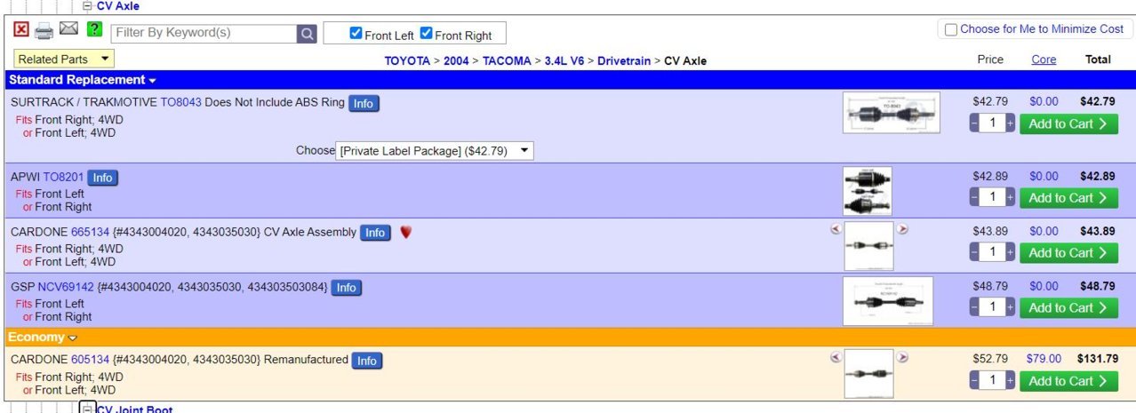

    Any suggestions on what replacement CV axles to go with? Just got under my truck and the boots look to be cracking a bit. The inners look about the same on both sides. I would like to try to replace them in the next two weeks because I am home from school but I'm not in a huge rush past that because it doesn't look too bad. I drive maybe 50 miles a day hunting but no 4wd needed. I would plan to reboot OEM axles with whatever boots are recommended to keep for when/if replacements have issues but it looks like to me I could get away with OEM boots again because these seem like they just cracked from drying out. Also is there anything else I should do while I replace both CVs? I saw some stuff about diff seals but only if they were leaking. Where would I want to check this? There is nothing obvious. Thanks
    I was looking ant just getting two of one of these options:
    Suspension is 883s and 5100s on first notch with arb no winch and~70 lb ifs skid
  8. Dec 7, 2020 at 8:01 PM
    #208
    eon_blue
    eon_blue Okayest Member
    Mar 4, 2016
    #180213
    69,210
    Azusa, CA
    O'reilly's has some new high angle CV axles for our trucks that a few guys on here are running and seem to like, they are interesting looking... I'll probably try them out next time I need CVs
    https://www.tacomaworld.com/threads/extended-travel-high-articulation-cv-from-o’reillys.674398/
    As far as aftermarket axles go they look promising. Other than that I would recommend going with rebuilt CVs from CVJ or direct from Toyota if you can find them in stock.

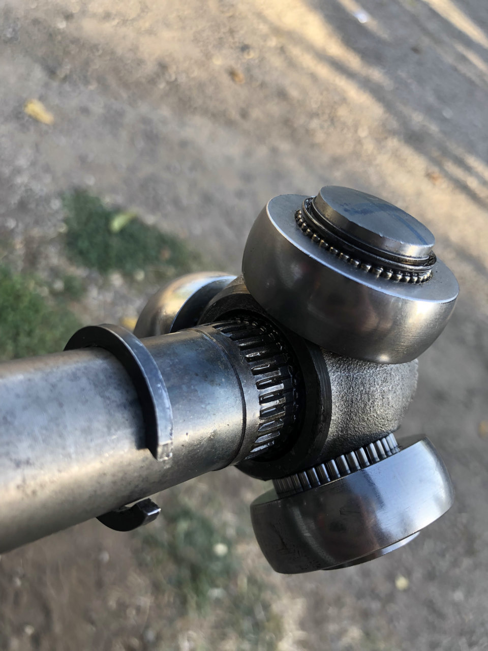

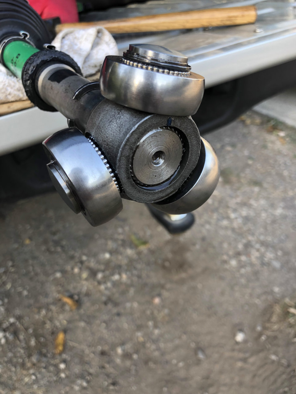

    I started the boot stretch mod this morning when my new boots arrived. Everything went as planned then I ran into a hiccup after removing the boots and the clip ring (inboard side). The tripod seems to be seized up on the shaft, I don't want to keep hitting the lip and risk damaging it, any one encounter similar problems and with a solution to share?

    So, in those photos, you're trying to tap the tripod further down onto the shaft, right? (that is, you aren't trying to remove it from the shaft yet). There's a retaining ring on the end of the shaft that keeps it from coming off. Not sure how a puller will help you get it further onto the shaft.
    Sounds to me like you have either (a) dirt or (b) deformed splines or (c) corrosion in the splines/tripod. I'd try some penetrating oil and brake cleaner (looks like you've used a bunch already), and then I'd use a steel tube that fits the tripod and goes around the shaft to try and tap the tripod further onto the shaft (to expose the retainer ring). At that point, if you don't have the tripod moving freely, the 3 jaw gear puller that @Nixinus mentioned may help to pull it off.
    Also, not sure if you've seen this, and of course, it just covers the general process - not the issue you've run into - but if not, it could be helpful to show you what to expect.
    How-to: Rebooting a Tacoma CV Axle
    this is the clip you are looking for:

    +1 seems like the ring on the end isn't removed @45thparalleln . Those splines look good to me, knock the tulip down towards the ring you just removed and you'll see the other ring causing you grief I bet.

    Much appreciated I knocked it down towards the shaft so the 2nd ring is exposed then very easy from there lol. I had no idea there were 2 rings so i kept trying to hammer it outward foolishly. Installation was cake, the fins are all nicely spread apart now no more replacement for a couple years i hope
