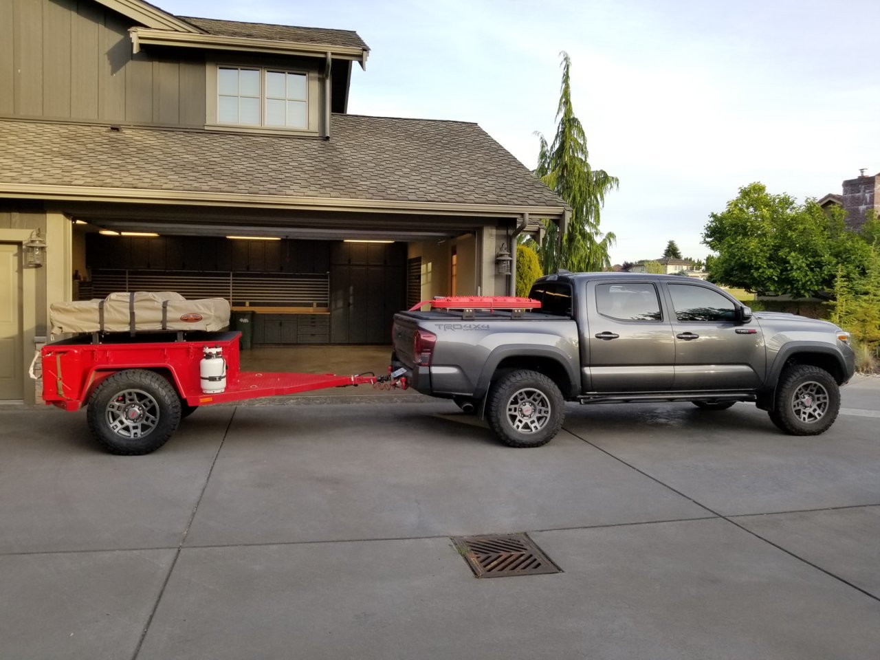

    I could be wrong, but I don't think you'll find a trailer axle with the proper Toyota Tacoma lug size (M12x1.5). You can certainly find them in the proper 6x5.5 (aka 6x139.7) pattern, but the studs won't be metric (M12x1.5). Additionally, most OEM wheels will use a hub centric design (use a mag lug) and will not be lug centric (use an acorn lug). This means that it will be nearly impossible to center the wheel on the hub.
    An easy solution to this, which I employed, was to use a set of Spidertrax wheel spacers. The Spidertrax spacer can be held to the hub using the factory hub lug nuts (acorn style) and will be lug centric. Then the Spidertrax spacer has a proper hub bore size (for Toyota hub centric wheels) and you can use the mag lug nuts.
    All of this is moot if you're going with an aftermarket wheel that is lug centric. Then you just need to be sure to use acorn style lug nuts that match the stud size of the trailer hub.
