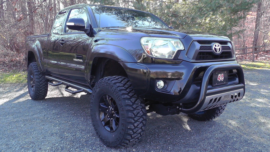

    I have 2 3/4" suspension and a 2" body lift in my 2014, running 33"X12.5" Mickey T's with no rubbing... I took a pass on the bracket lift!7%204_zpsif3ilhkh_365f2b9c0fde57cdb092814f617e2ddace236b93.jpg

    Before body lift
    With 2" body lift
    Before
    After
