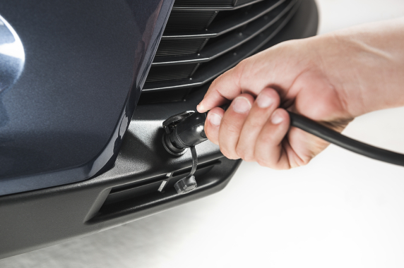

    this is where and what Toyota oem block heater plug in looks like.
