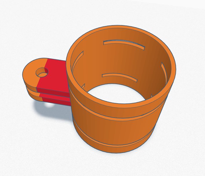

    So, like another well known poster here, I made something because it doesn't exist. I'm footing the bill for the few first prototypes, but wonder if anyone has any thoughts on this design.
    Basically, it'll mount to the GoPro shoe that slots into the GoPro mount. It takes 2 decent o-rings to loop around. The cutouts will allow the o-rings to transit the inner diameter a little bit and provide sufficient friction to hold the Blackvue from moving around. The sleeve itself is probably 0.5mm or less, larger than the Blackvue. So it should be a pretty decent fit.
    Thoughts anyone? Or am I just way overthinking this and should just slap that supplied sticky mamma up there?

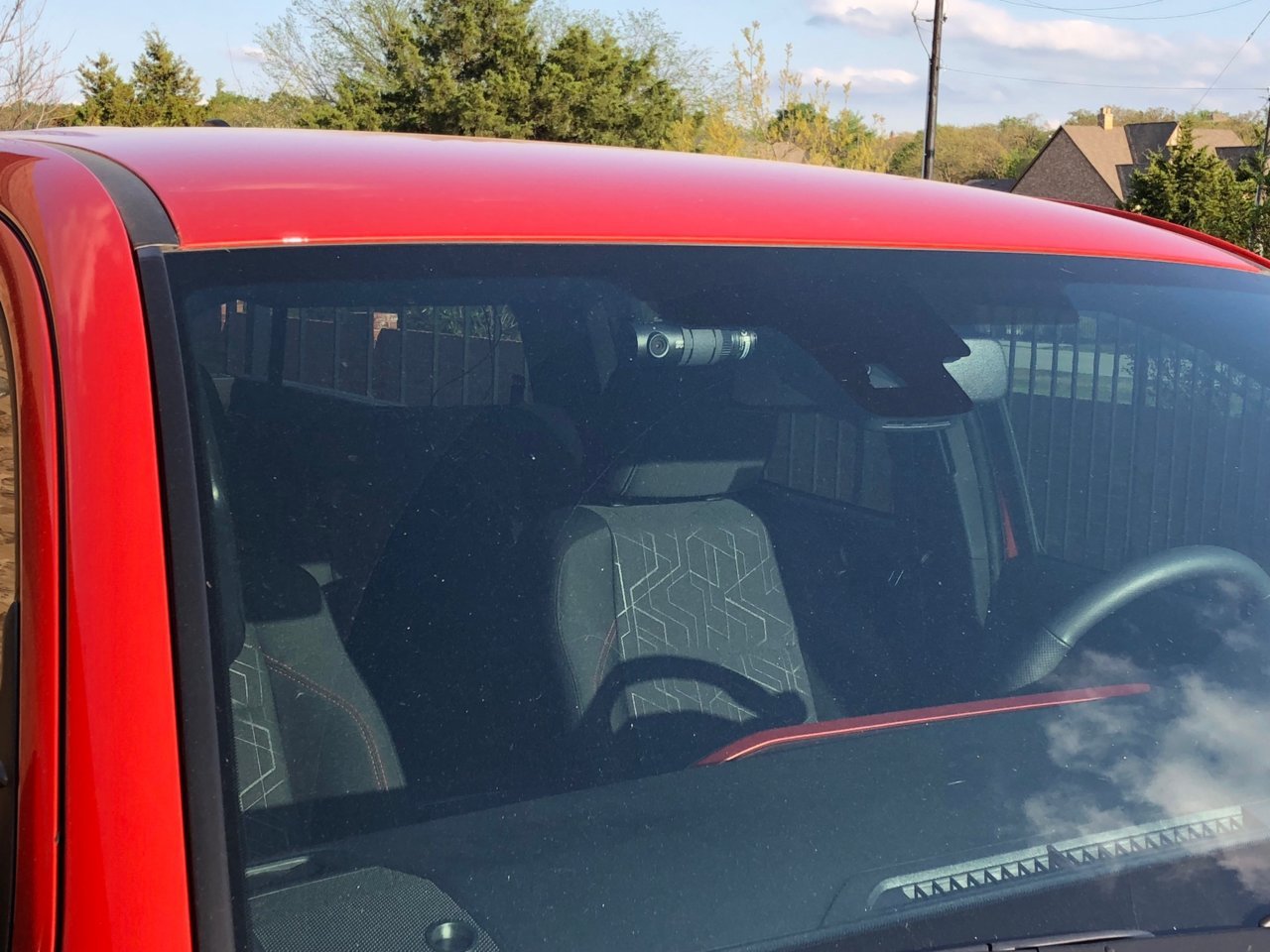

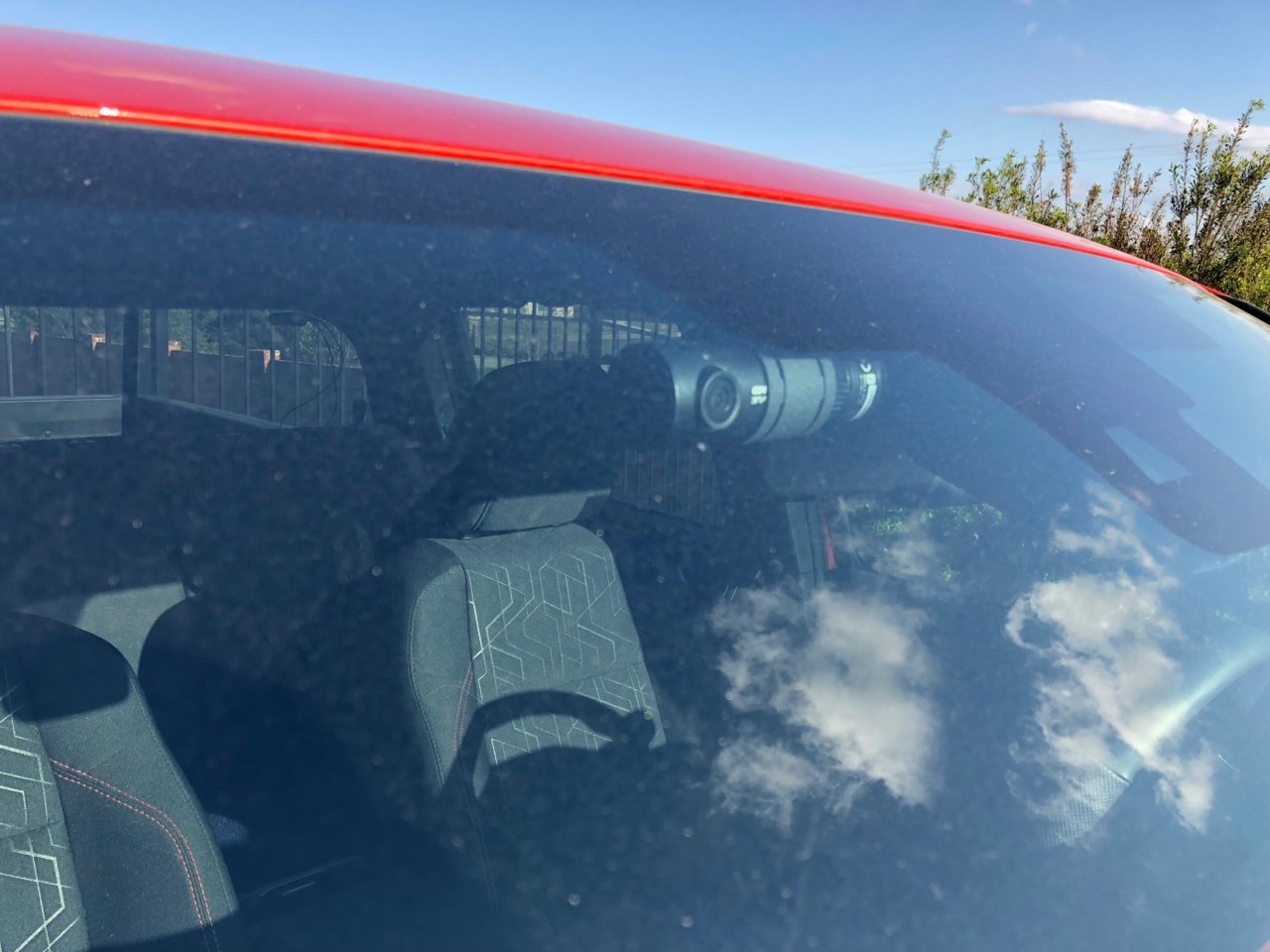

    First pic, closeup from outside
    Second pic, distance outside

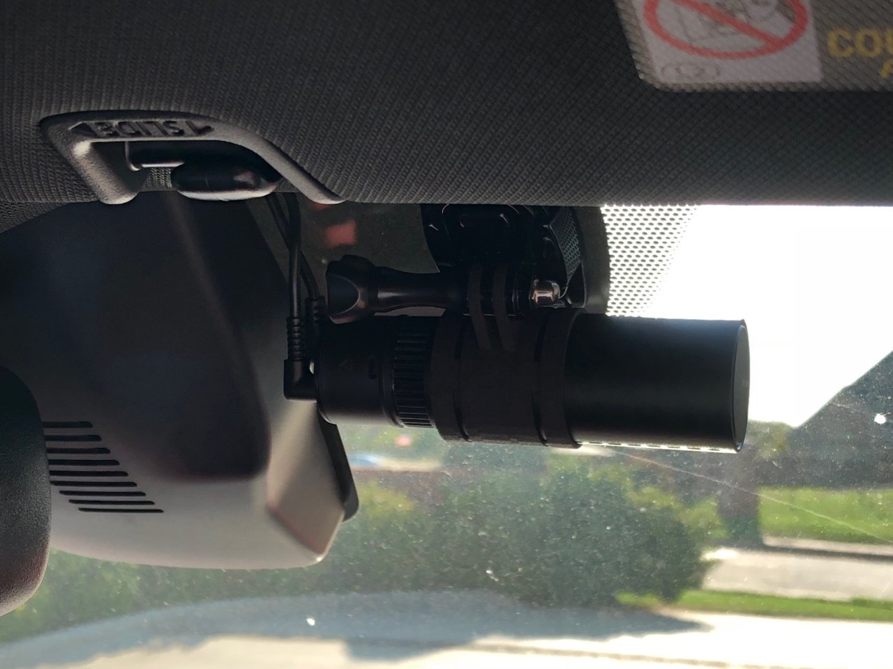

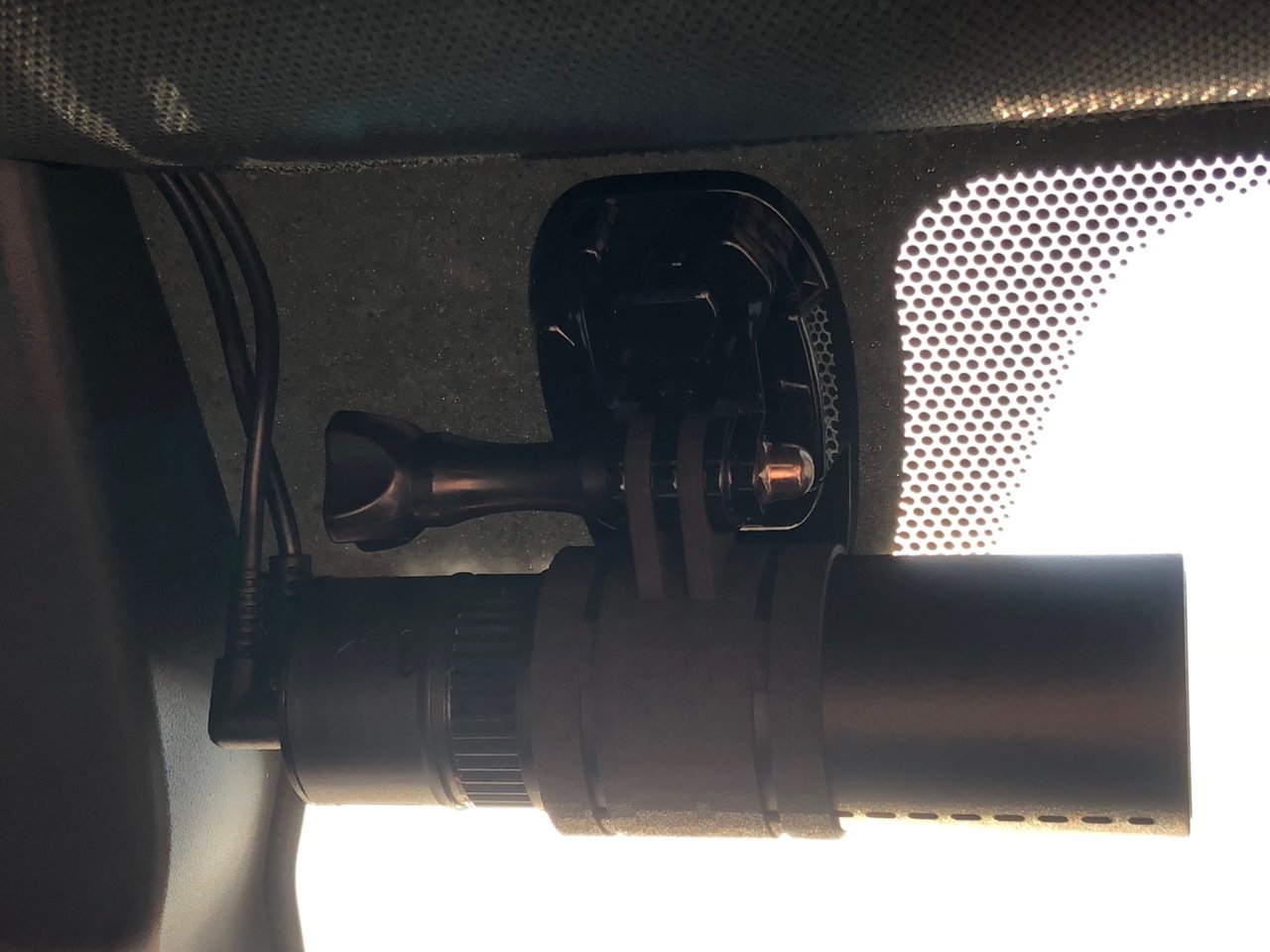

    Third and fourth pics, closeup inside
    It's not what you would call discrete. But it is a clean install. In the second pic you can see how big the footprint is for this mirror. In theory, I could use this mount as a proof of concept, and redesign with an offset to put the camera wherever I wanted. I honestly don't notice it anymore.
    It turns out I don't need the O-rings I bought. The sleeve is just snug enough that it holds the camera tight enough to not worry about it. We'll see how it does when Texas hits 105 this summer. I had the sleeve printed out of nylon using SLS technique. It does have a little bit of texture to the surface, but it's pretty smooth. You can see the edges that make up the circle. Thats mostly a function of the free software I used for designing. The teeth you see on the camera in pic 4 are for it's mount. It has a collar with a 3M sticky designed to go on the windshield.

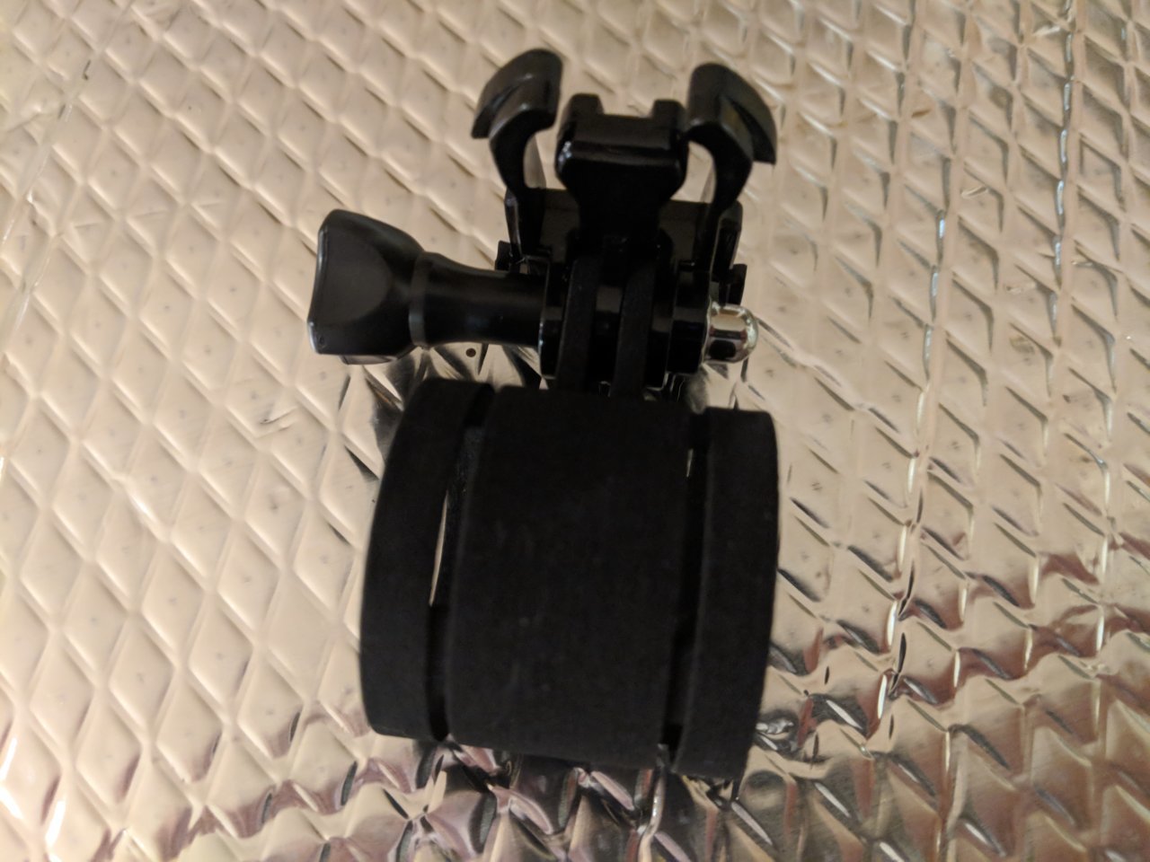

    I have my GoPro mount for sale with the GoPro adapter in my for sale thread (click link in signature line)IMG_20180830_195758.jpg
    It's sold....
