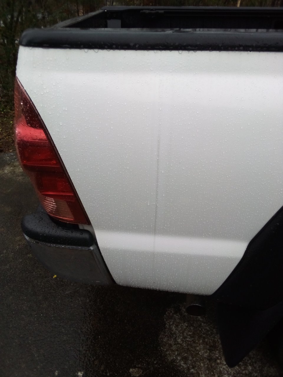

    How to eliminate these?

    Can you tell us what you have tried to remove it?
    I’d probably try bug and tar remover first, if that didn’t work, then polishing compound, and maybe a clay bar?

    It's happens all the time and I use polishing compound. Hassle. Thought a spray would be easier.

    Think ya need a ceramic wax

    Looks like plastic dressing residue runoff to me. Did you just put something on the plastic trim to make it look better?

    ^^^^ This. And stay away from polishing / rubbing compound to remove it. That stuff is way too aggressive. A very mild polish or even most all-in-one cleaner / polish / waxes available at your local parts store should remove it.

    Mine does the same thing, and if they sit of there for a few days they can be almost impossible to get off.

    If you're using any kind of protectorant on the black trim, that's your issue. Any cheap spray ceramic (like Turtle Wax hybrid) will keep all exterior black plastic black, last for at least six months and most importantly not wash off in the rain causing streaking. YMMV

    I believe all colors do this. Just really shows on white. Just wash your truck. I wash mine by hand and it washes away easily. I used Turtle wax spray on ceramic coat with 2 applications for the first time last fall and it seemed to help this winter. Washed off even easier.

    Magic eraser :thumbsup: followed by wax ​

    All vehicles will have streaks if not properly maintained. This is not a Toyota issue, it’s an owner issue.
    Absolutely not. Magic eraser is an abrasive and will scratch/dull the paint.

    That’s why you follow with wax. However, if you were to scrub hard it would absolutely scratch the paint. I’ve actually used it on more than you could imagine including headlights and it works wonders. People just don’t know how to use stuff gently. It’s all or nothing on scrubbing lol

    Agreed on the owner issue though. That truck just hasn’t been washed in forever
