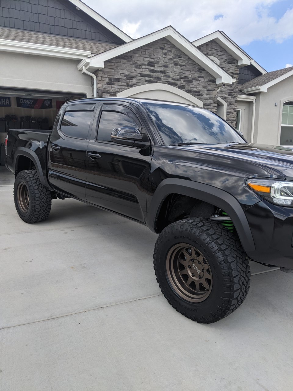

    Here some pictures for black rhino stadium wheels on a black 3rd gen taco. Only posting just in case someone wants to see it
    RC 2" leveling kit just in the front
    285/70r17
    17x9.5 with -18 offset
    Minor rub with no trimming

    Looks really good! No cab mount chop?

    Nope. Once I do a cmc. I shouldn't rub at all.

    This is it on an ironman lift

    Nice truck! After seeing the stadium on your tacoma, i've pretty much convinced it's going to be my next upgrade. My only question is, the hub bore on these are 112.1 compared to 106.1 hub bore of the tacoma, did you put hub ring on it? Thanks in advance

    I did not put a hub ring on it.
