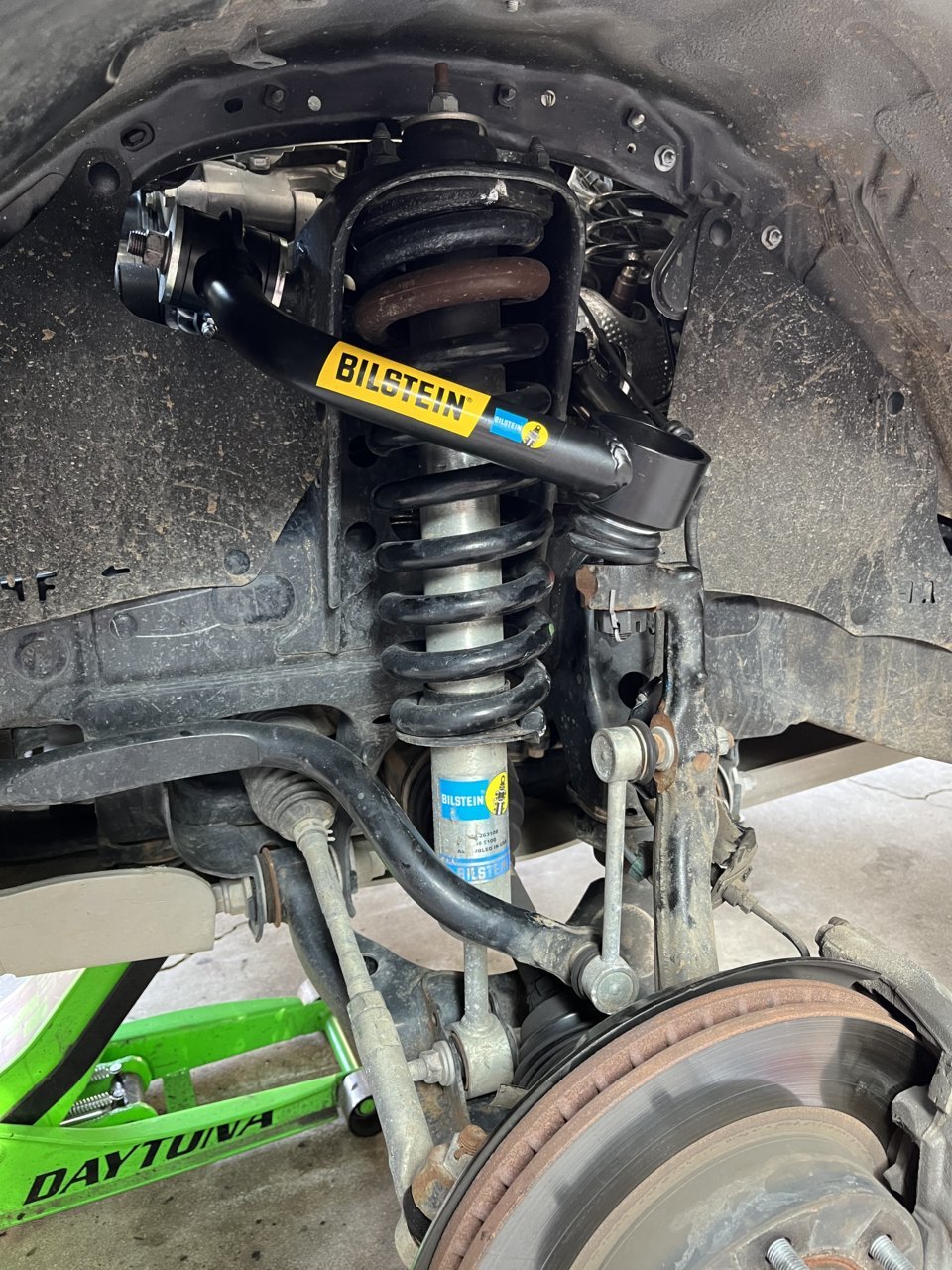

    Huge shout out to @Superdave1.0 What a pro and actually allowed me to get my hands dirty helping out.
    Probably the only complaint I have about these bad boys is there is no supplied dust cover for the ball joint zerk.
    But rumor has it and confirmed with Bilstein that Dirt Kings fit!
    Removed the old UCA bolts by cutting them off and installed new ones turned around so it was easier and didn’t have to bend a bunch of sheet metal.
    Bushings and sleeves went in perfect with a press and careful setup.
    In fact I don’t think I need an alignment but I’m getting one anyway. Rides AWESOME!
    All I can say is easy day thanks to Superdave. Mahalo brother!

    Late post, but I bought some of these back in September and just now got around to trying to install them. I spent over half an hour trying everything to get the bushings to go in, to no avail.
    I contacted the distributor late last night to see what my options are.
  14. Mar 5, 2022 at 6:02 AM
    OmahTako
    OmahTako [OP] Well-Known Member
    Jul 3, 2021
    #370309
    1,601
    SoCal
    Tacoma-1ea. Tundra-1ea.
    Put the UCA in the sun or warm them up. Put bushings in fridge. Grease and install.

    Update: I tried all of the above and still a no-go. 4WP was kind enough to coordinate w/ Bilstein to get some new bushings to me. Same part #. Same result. They refuse to fit.
    I bought a 5” bolt, two large washers, and a nut, in an attempt to tighten it down and squeeze the bushings into place… nada.
    Emailed 4WP Sunday to see what my next options are. Super disappointed that the Bilstein UCAs aren’t working out. Hopefully we can get a resolution and I can proceed with installation soon.
