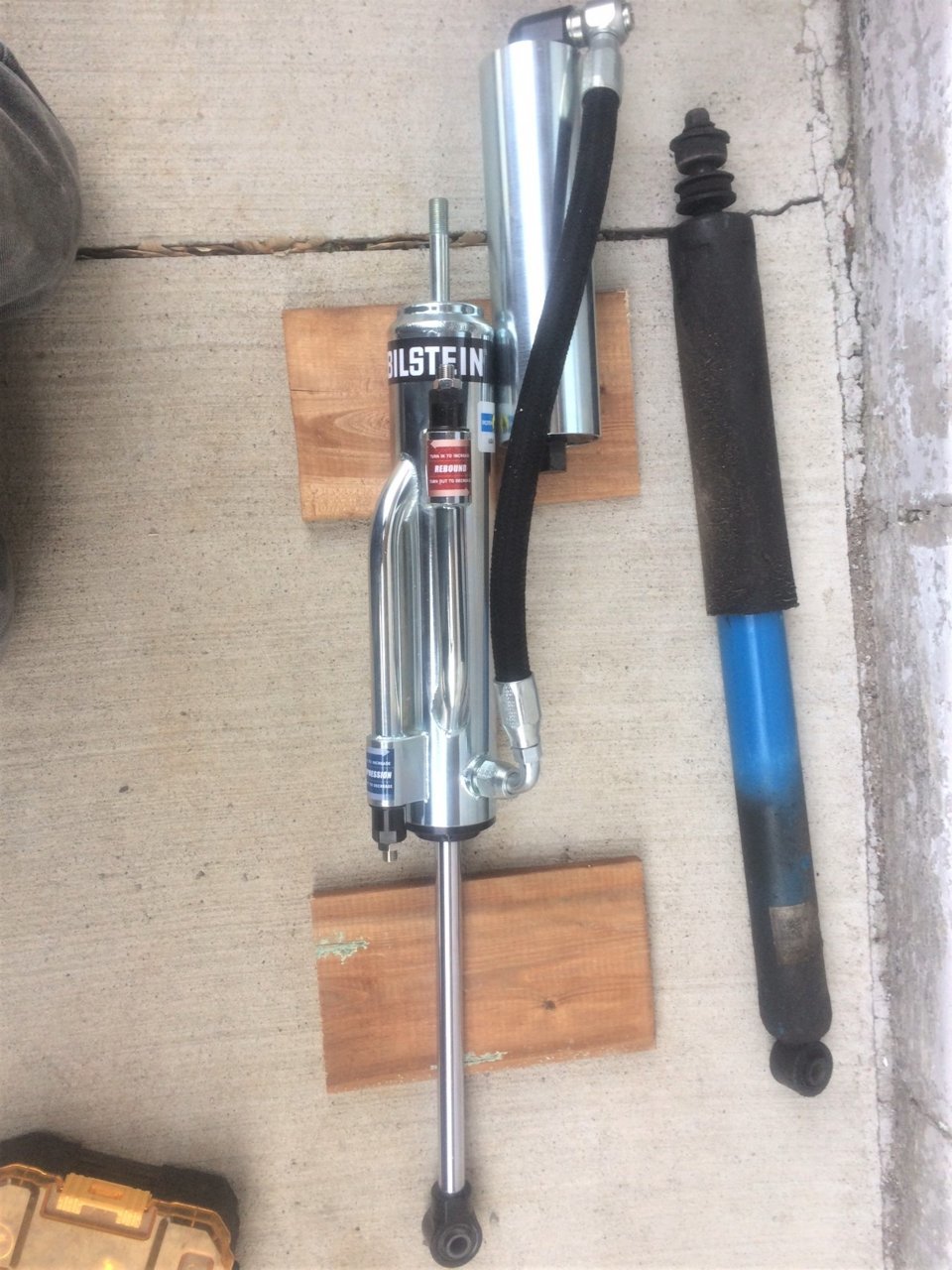

    Yeah the extra body size really does make a difference.
    Also gives more room for the valves so the shock can be move variable through it's stroke. Can't stuff too much in the ity bity stock shocks.
    Stock Sport and OR shocks look like pencils compared to a real shock.
