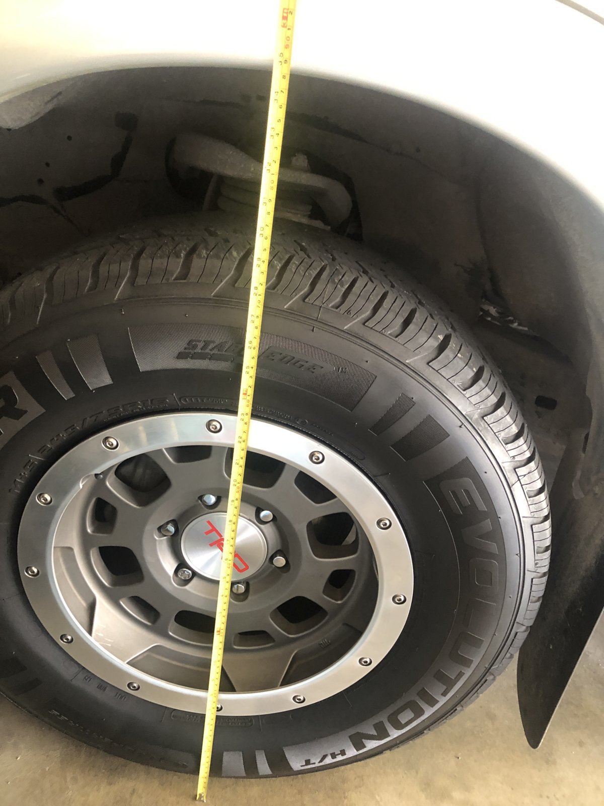

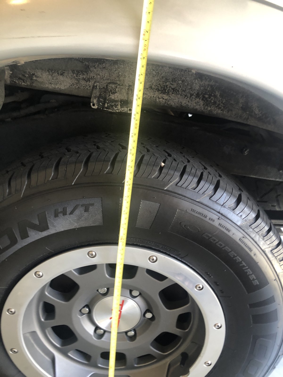

    Front and Back High measures Picture with KYB before installing bilstein 6112 /5100 rear and the Alcan leaf pack
    Black97v6MT[QUOTED] likes this.

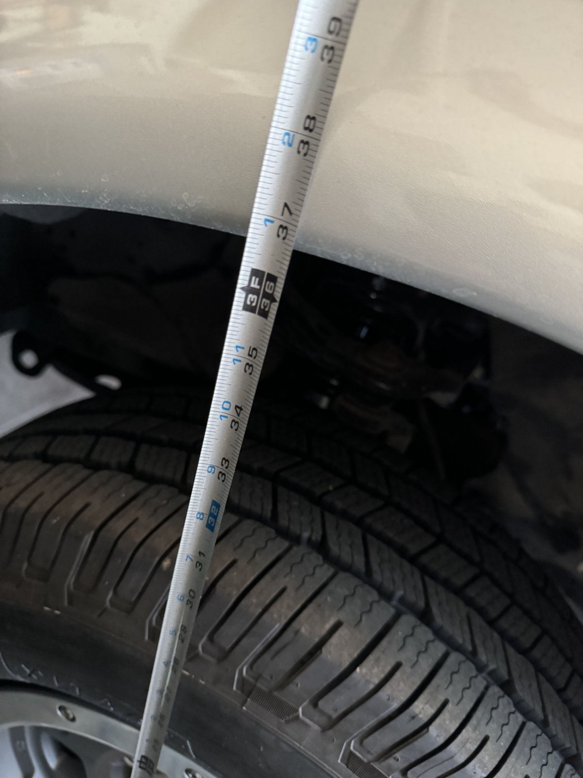

  11. May 26, 2024 at 8:38 AM
    2002Tacoma4x4
    2002Tacoma4x4 TRD 4x4 double cab
    Dec 20, 2014
    #144634
    1,051
    C K
    Limited Edition Double Cab TRD off road 4WD
    pictures with the new measures after set installed, tires used to be cooper 245/75/16 changed now to the OEM size at door 265/70/16 Michelin, Bilstein 6112 set to stock high
    Black97v6MT likes this.
