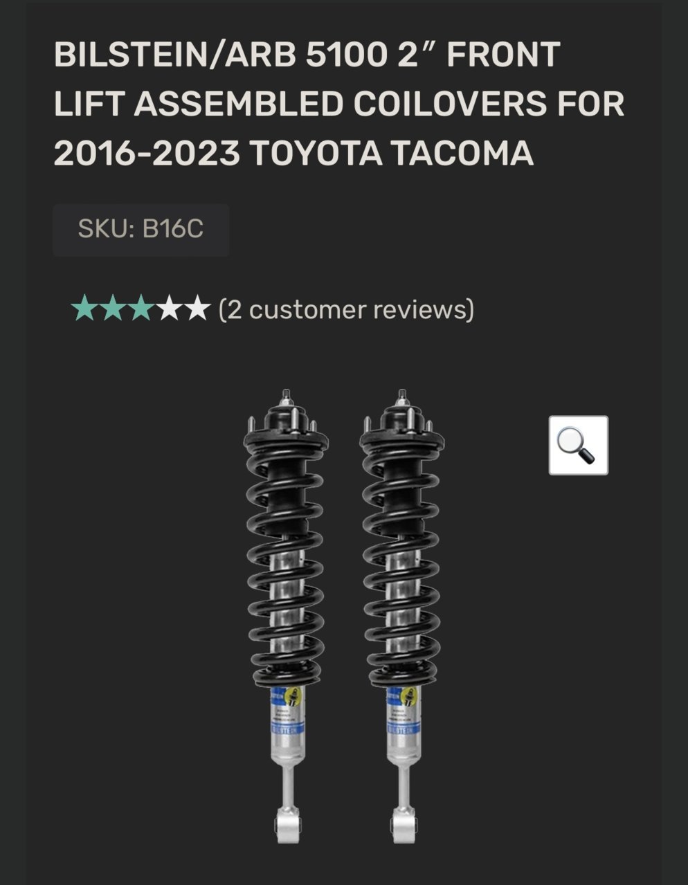

    I see everyone talking about the Bilstein 5100 so i’m definitely going that route. But not understanding people setting them a certain size to get a 2” lift when they have this set up (pictured). Should I get the adjustable ones to achieve a 2” lift or can I go with this? Money isn’t the issue for me. Just what’s easiest. Also what am I going to need in the back to keep it at factory rake (or level)?

    The 5100’s were designed by Bilstein to retain the factory coils. You don’t have to replace them to achieve lift. The shocks themselves have an adjustable perch that sets the height at various levels. Bilstein recommends 5100s use stock Tacoma coils to retain their lifetime warranty.
    The rear 5100’s do not work the same way so you would need to use lift blocks or an add a leaf to the existing leaf pack. Each version has pro’s and cons .
    Toyotas own Trd lift kit is just rebranded 5100’s with 1” rear lift blocks . Basically set@ 2” in front and 1” in the rear which gives the Tacoma a level stance.

    Thanks for the info, that’s pretty much what I thought. I just rarely see anyone talking about the set up that comes with the coils. I guess it’s just presence? Less money? I rather get all new parts than use my OME. I’ll store those in case I need it down the road.
    But what do you mean maintain lifetime warranty? On the Tacoma coils or the Bilstein strut?
    As for the rear, what do you think is best? I don’t off road really. Just dirt trails and the beach. Other than that, it’s a daily driver for me. Just looking for my truck to sit higher.

    Stock SR5 has about 1" difference between rear and front(rake) If you add 2" in front, need to compensate the rear.Typical add-a-leaf gives 1.5" lift.
    You can use non-OEM coils. 885 will give you 1.5-1.8, 887 - 2" and small change in both directions

    I'd definitely get them assembled with OME coils installed. I would shoot @HeadStrong Off-Road an email for an invoice with the 5100s preassembled with 885 coils and the taco lean spacer installed.
    I had 5100s/885 coils and a 1" block in the rear and it was super level. Ever so slightly higher in the rear but looked perfect IMO. Ran the 1" block with the stock suspension in the rear then figured I'd match the front and got 5100s for back there as well. Check my post in this thread for pics

    OME springs are known to sag. I was going to do OME but decided to skip on them and keep the original springs as Bilstein designed them to be used with the factory coils. By doing this it keeps the lifetime warranty.
