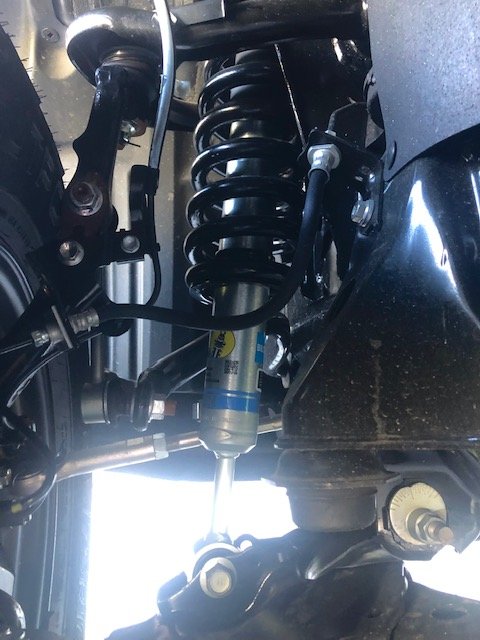

    All four Bilstein 5100s installed on the 2023 SR without an issue. Front set on 4th notch (gained about 1.5 inches in the front and another .5 with the 265 tires). This is a must if you are running bigger/heavier tires. The ride is way better, way smoother and more planted compared to 265s on the stock Hitachis.

    Beautiful looking truck. I recently just got a SR and want to put Bilstein 5100’s all around. Did you use the stock front coils? Height looks great and that is what I am trying to achieve.
