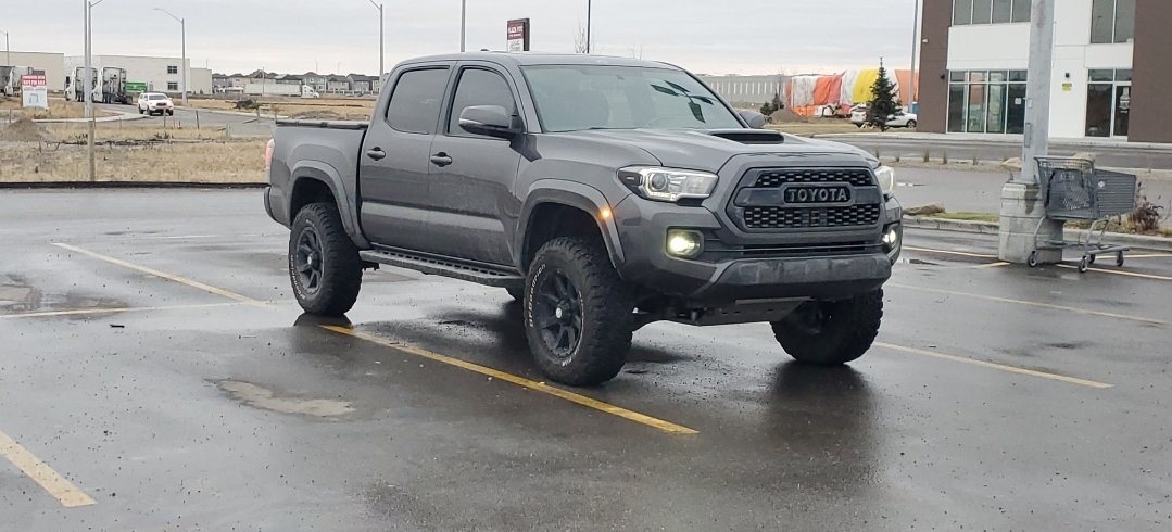

    Front and Rear lifts Tires ECGS bushing Lots of other crap +HP sticker
    Yup. I did. (Not a SR5 though) Alignment went well and no issues 5 years after.

    This was one of the lifts I was looking at for my sr5. I want up to 2" of lift but I going to tow a pop up thats about 1800-2000 pound. I don't want to do anything that would make it suck really bad at towing. I'd guess I'd need to keep tire size @ no bigger than 265/75r16. Would keeping my stock dark charcoal wheels be an issue?
    The way @stealthmode pic looks is really good.
