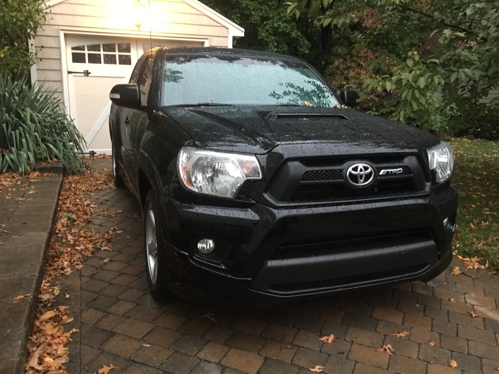

    I bought my 2013 X-Runner in October of 2016 off a dealer lot in Pennsylvania. The truck was originally sold at the same dealership and was a recent trade in from the original owner with only 26,000 miles on the clock. The truck was basically bone stock, and at the time I bought it, I was thinking of using it as a daily driver, and really had no intention of ever modding it.

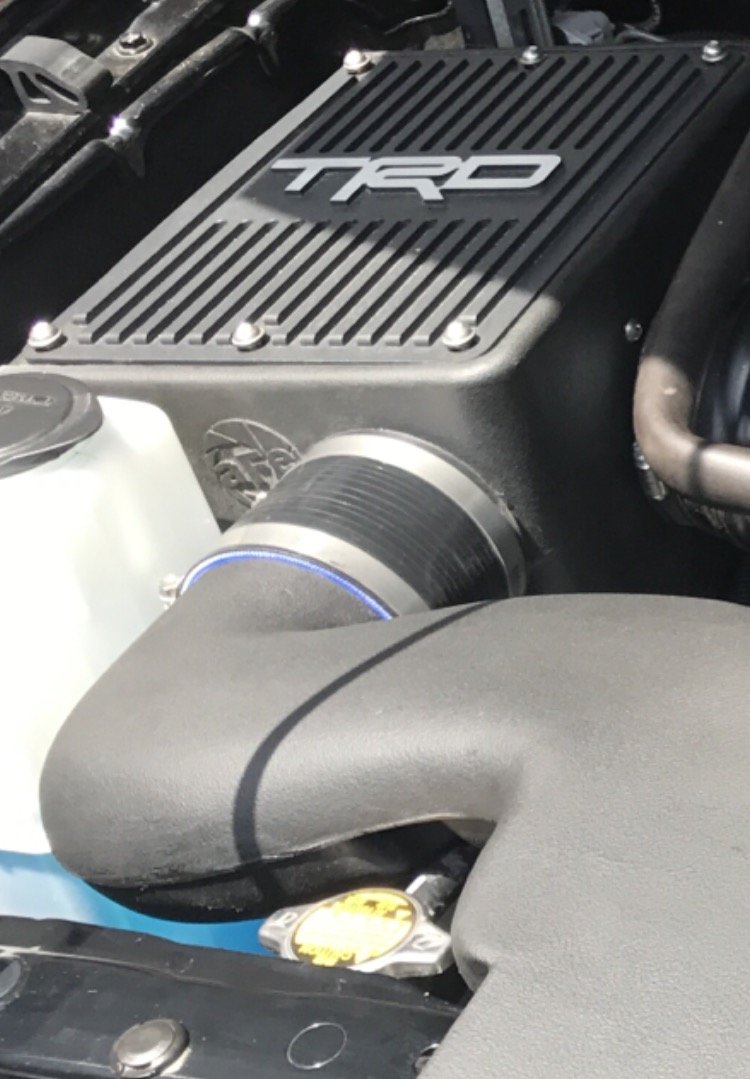

    After I got the cam gears installed it seemed that everything else went together super easy. The new snout with 2.7 pulley, the URD 180 thermostat, and the 7th injector.

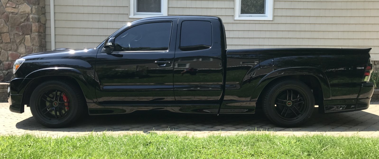

    And a side view:

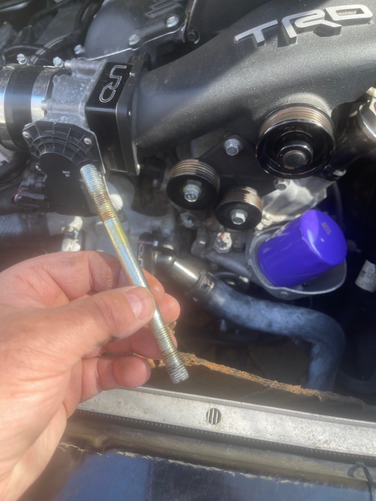

    Not being able to leave it well off alone, I still wanted a little more power since I felt the 2.7 pulley just wasn't doing enough for me. I went ahead and bought URD's 2.55 pulley and installed it.
    Unfortunately, this is where my problems started. Although it pulled better and quicker, belt slip was killing me. This was still in the summer of 2017, way before guys who are much smarter than me figured this all out. I became a bit discouraged with it, having to go easy on it most of the time, and constantly worried about overheating the belt due to slipping and it snapping. To make matters worse, I was going through some rough times, and basically put the truck to the side and worried about more important things in life at the time.
    Jump ahead to 2023, most of all the bad stuff was behind me, and I was still breathing, so I got some renewed interest in the Tacoma.
    This is where the folks on this forum came in to help big time. Since the xr forum is pretty much a ghost town at this point, one day out of the blue I decided to post up a reply on the TRD/Magnuson 4.0 Supercharger Tips, Tricks, and Mods thread here saying how I was considering going back to a 2.7 size pulley to eliminate the belt slip issue (at that point, I had no idea this issue had already been figured out by folks here long ago).
    Instead of flaming me into ashes, everyone who responded was very helpful and pointed me in the right direction. I soon did my research, and decided on a Rousch tensioner, upgraded long studs, and the @BillDaCat8 wrap mod for my 2.55 pulley.
    I bought an OEM VW pulley for the wrap mod, and @XPOTRPR was super helpful by offering to machine the pulley to spec.

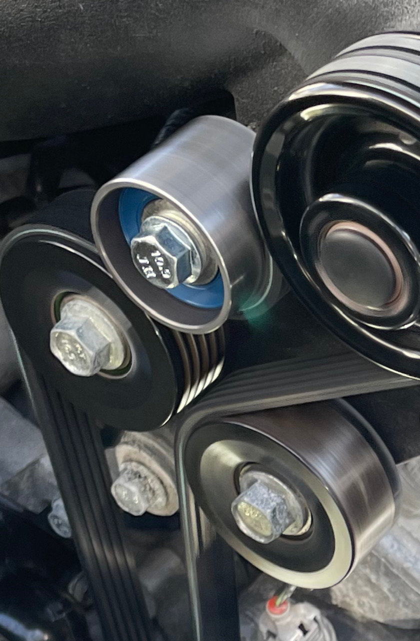

    I finally got the chance to put aside a day to finish up a few things on the x-runner so I could finally enjoy it. First thing is installing a set of new RB VVT solenoids. A huge thank you goes out to @SUMOTNK for sending these to me at the group-buy price! :thumbsup:
    Installation was easy peasy :)
