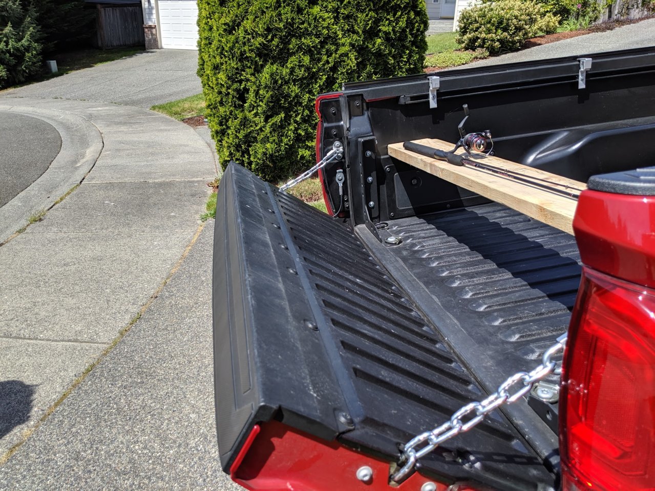

    A cheap solution is a buy a 1x6-8 or 2x6-8 and put four fork mounts staggered or angled on it and throw it in the back of the truck near the tailgate. I drove across the country with this setup like this before I got a hitch rack. Of course, it takes up the whole bed and you need to take the front wheels off and put them in the bed too. Not a high-dollar investment if you don't like it, stores easily and can be removed in seconds.
    Not my setup but an example of what I'm talking about.
