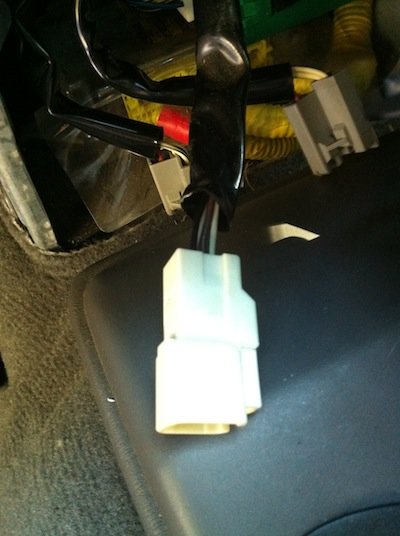

    I've been busy with work and raising a family but found a little time in the chaos to check up on my beloved Cargo. Figured this would be a good time to update my build with a little minor mod.

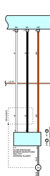

    I learned that my 04 taco had a few additional hidden features that came with the keyless system that I've been itching to unlock. Over at customtacos I was a bit dumbfounded that my rig had already come with a fully functional factory alarm and that all it required was the unplugging of a white wire. Seriously? :confused::p Here's the popular CT thread on how to do it.
    I did have a bit of trouble finding the unused plug under the steering wheel. After almost giving up, luckily a helpful member, Smuook, was able to point me to the right direction on where to find the plug on our 04s. He also shared with me how to wire up the Glass break sensor and LED module. Also, found that another guy over at cardomain was able to find the plug as well behind the center console.
    Here's the unused plug that I finally found behind the radio:
    Here's the GBS/LED module:
    Here's the wire diagram I managed to find on the internets:

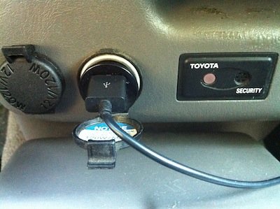

    Will consider the remote, thanks for the suggestion. Also wondering if there is some type of mountable USB outlet that I could install at the end of the extension cable in a convenient location that would flush fit in one of the bezels/console for a factory finish look. Seen any such, where did you run your USB cable end to? I'm also playing with the BT mic location currently on visor overhead until I determine if there is a better location.

    I just finished the car alarm. What a cool little mod. I literally just unplugged that one wire and then tapped into the 4-prong wire and put my red LED bulb in the blank spot next to the center air vents. Once you lock the truck the light stays on continuously for 30 seconds and then starts blinking when the alarm is activated!
    Thanks OP!

    I have my USB cable temporarily routed in my glove box for now. I like your idea of adding a USB outlet. I've seen the toyota factory USB outlet style in my brother's new 4runner trail edition. Looks something like THIS unfortunately it doesn't have the exact dimensions to fit in our 1st gen spare slots.

    Nice!! It's one of the cheapest mods I have done to date! :D I rewired mine the same, tapped into 2 of the 4 wire plug to an aftermarket 12volt red LED. I ended up mounting the LED up high near my rear view mirror so it's viewable from the outside for my needs. I live in a townhouse where my truck is parked in front under a carport and it's comforting to see the red LED blink from my kitchen window. I placed it there to help reassure to myself -in the comfort of my home- to peek into the window to see if I remembered to lock my doors and that Cargo is safe and armed. Later I plan to wire the aftermarket LED in parallel with the factory GBS/LED module so that there's a status light viewable from the interior as well.
