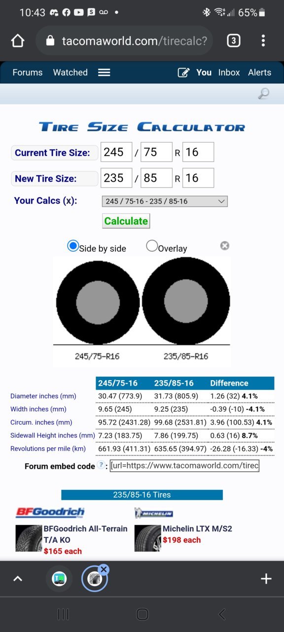

    Rep just msged me again and said he found some 235/85/16s that will fit these tirrs. I have no seen a single person say they have 235/85/16s since I joined this forum. But this is their dimensions compared to my 245/75/16s currently
    Not sure If this is the best option but I do like ko2s

    those are barely any taller than my current 245/75/16 according to the calculator

    I mainly want it taller. But it seems if I want it taller I have to sacrifice width. If I want it wider, I can't have height.

    That's 100% correct. The second number is a ratio/fraction if I recall of sidewall height versus the width.
    When I had the SR5, I needed more width. They looked like pizza cutters and I hated that. The duratracs were taller, but I assumed thats just variations in tire manufacturers measuring the tires.
    I'm pretty sure some people fit 265/75/r16s on off-roads. I know your tire dude said no, but really that's logically the next step up.
