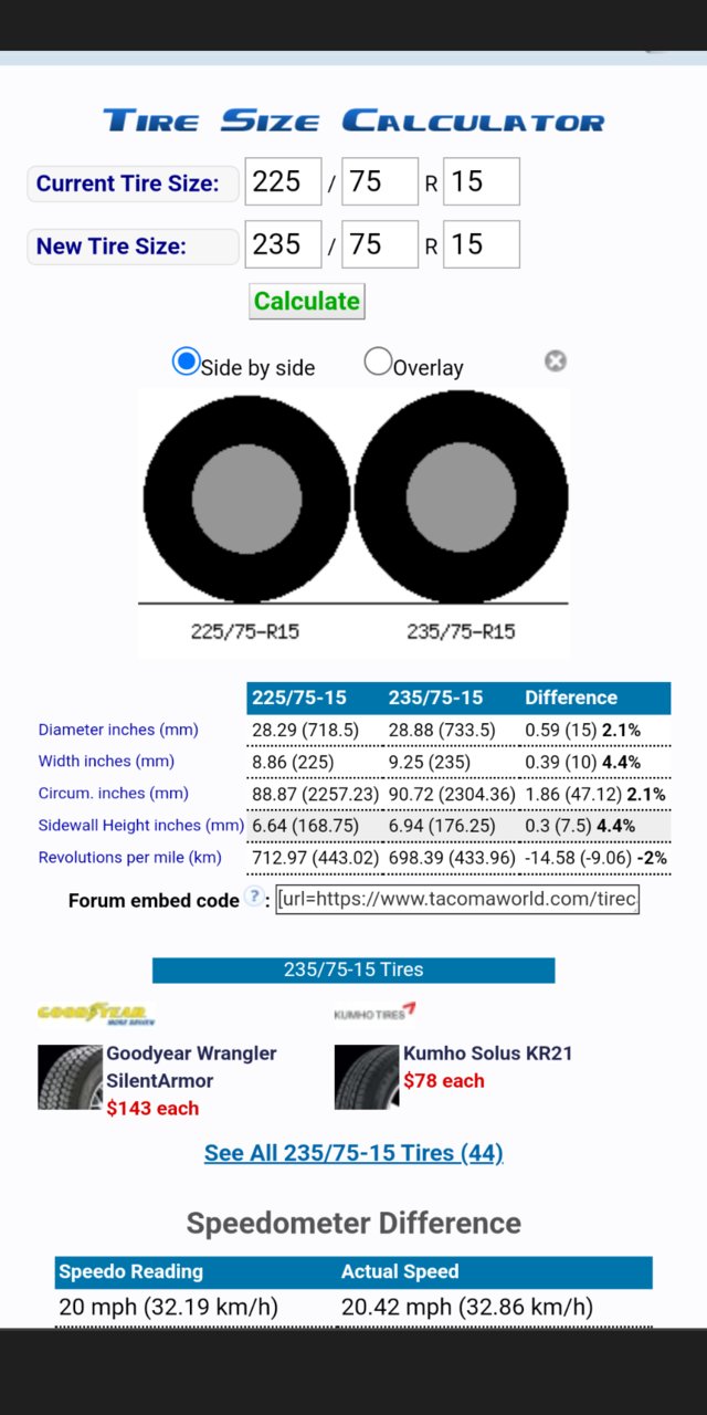

    Actually, it's the opposite. Overall, I think the effect here is much less than you're thinking it is and personally, I'd just know what the difference is so you're informed but other than that basically ignore it.
    A larger diameter tire will cover more distance per revolution than a smaller diameter tire. Since your tires are larger than stock your speedo should read LOWER than your actual speed. And your odometer would also read lower than actual mileage.
    Second, where's the math that got you to a 10% difference? There's no way that's correct. That tire size difference is pretty minor, mathematically the circumference is 2.1% different.
    If you do the math your speedo should now be slow by 0.4mph at 20mph, 1.1mph at 50mph and 1.5mph at 70mph. On my truck (which is a 2nd gen) a 1" larger diameter tire actually made my speedometer more accurate. I tested it with GPS and with the larger tires the speedo and external GPS match dead on.
    If you do the math on mileage, it's basically the same situation. It now takes 699 revolutions to go 1mi vs needing 713 revolutions with the stock tires. That difference of 14 revolutions is equal to ~104'. So, for every mile that your odometer racks up you're actually going 1mi plus 104' - which is ~2% difference.
    I think this is relevant for speed so you can be sure you're not going faster/slower than you think you are. But I wouldn't worry about mileage. Mileage is a good gauge only because thats kinda all we have. It's not actually an accurate measurement at all of a vehicle's condition. It doesn't factor in how those miles were put on, how many revs the engine has been through, how many cold starts...etc.

    Linear relationship, not exponential. Increase in circumference from stock to bigger tire is what the odometer is short.

    The math is not complex.
    It is simply based on the circumference of the tire. Circumference = Diameter * 3.14.....
    A ratio can be set up between the small and big tires.
    Cbig=Dbig*3.14
    Csmall=Dsmall *3.14
    3.14 will cancel from both to leave just Circumference and diameters.
    Or it simplifies further to be just a simple ratio between the diameters.
    Example: moving from a 31" tire to a 33" tire. 33/31 = 1.06. The 33" tire is 6% bigger circumference than the 31" tire. Meaning the speedo and Odo will read about 6% low.
