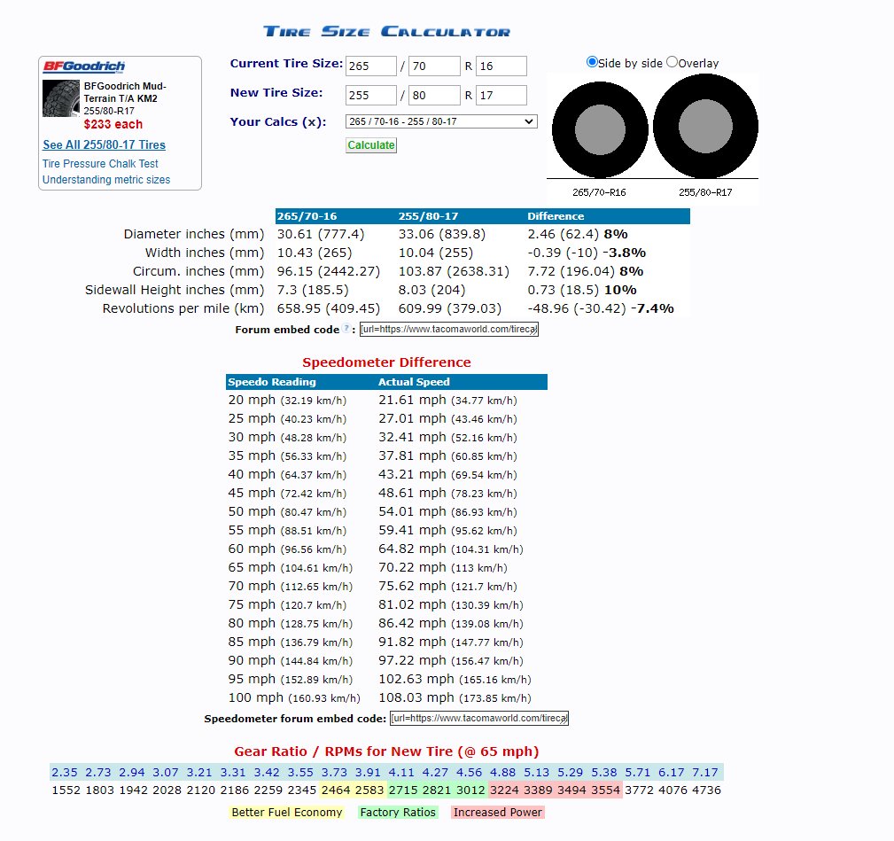

    You did a lot of math, but there is an easier way. Plug the numbers in here Basically the new tires are 8.2% larger. When compensating for the speedometer and odometer simply multiply the numbers your truck displays by 1.082. For example if your odometer says you drove 250 miles then 250 X 1.082 = 270.5 miles actually driven.
    You can also recalculate to find your true axle ratio by clicking on that link. Assuming you have 3.73's from the factory you now have 3.45's.
    Speedometer calculations are now given. If your speedometer says 70, you're actually doing 75.

    Its really a simple ratio between the old tires and the new tires based on circumference. This can be simplified to use the overall tire diameters, since 3.1416 is a constant in both.
    33.06299/30.60629 = 1.080.......
    This is the multiplier to use to correct your speed and miles driven.
    Done. EZPZ.
