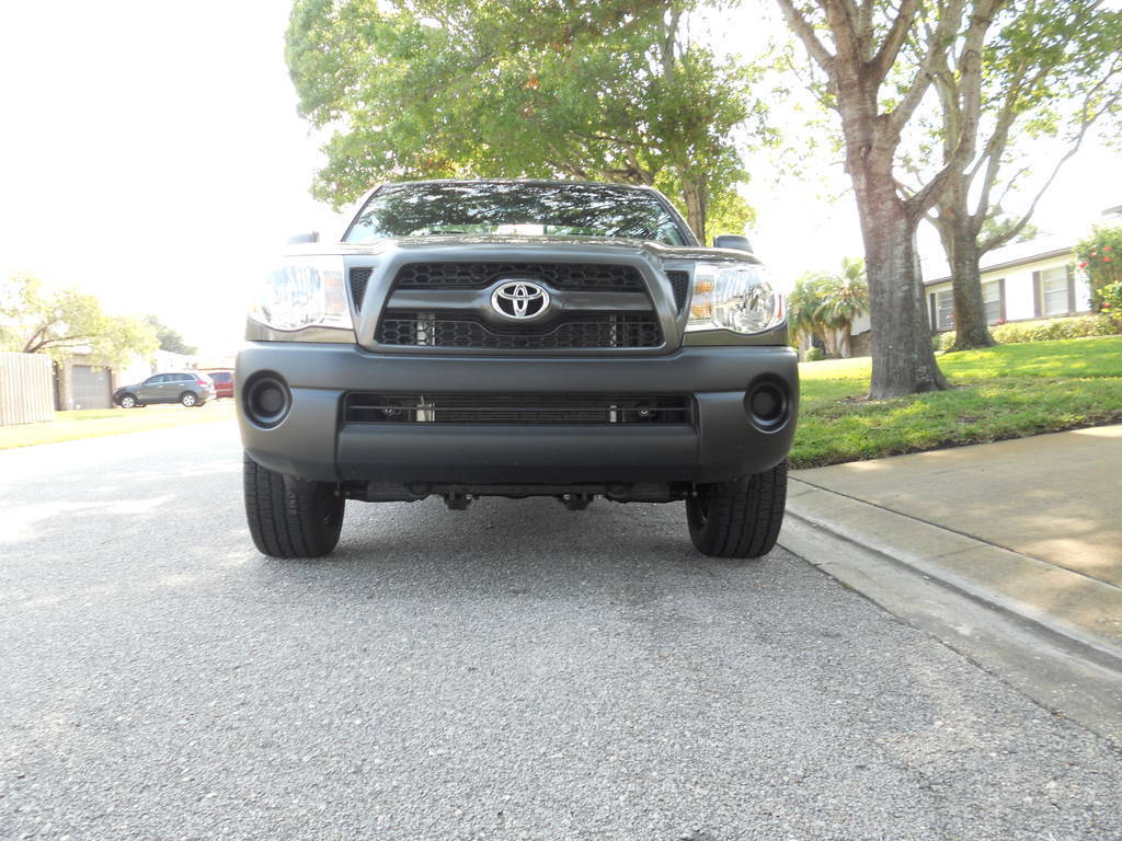

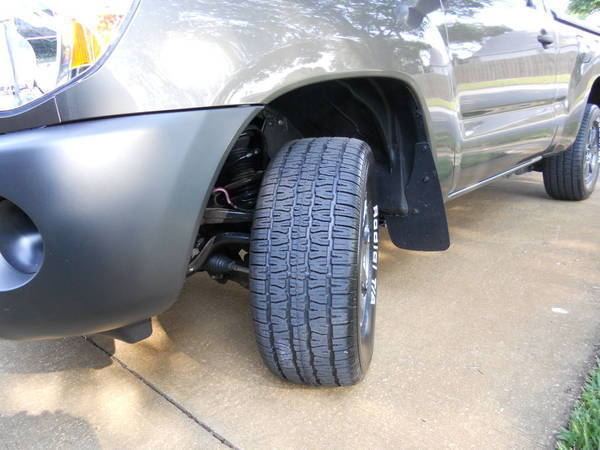

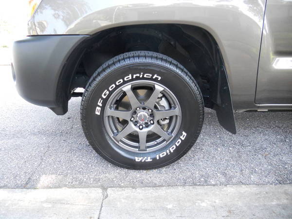

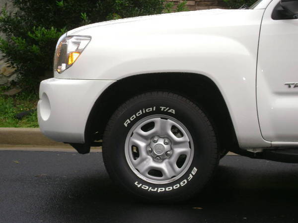

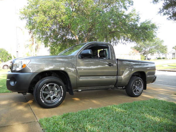

    Here's some borrowed pictures to get the discussion going...

    So the question is how do they handle - stiff? Powersteering work overtime to turn 10" tires? etc....
