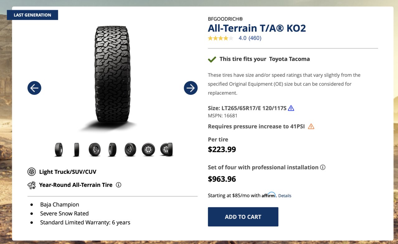

    Hello All,
    I know there is always the big PSI debate. I for one ALWAYS go with the tire's rating for the GVWR of the truck at what PSI the tire requires. I noticed now BFG puts the recommendation to 41psi on their page. See below where it states "Requires pressure increase to 41PSI"

    1,954 lbs inflated load rate for LT's.
    2,149 lbs inflated load rate for P and euro metric.
    Easy-peasy.
    The BFG site is actually correct; color me surprised.
    About inflating to GVWR...
    If you're inflating to GVWR(5,600 lbs), that's 1,400 inflated load rate per tire.
    LT load chart does not go below 35 PSI @ 1,765 lbs inflated load rate(for a LT265/65/17).
    How are calculating that?
    Even if you extrapolated a value per PSI from the 35-40 PSI range that would put you at 25 PSI for this size LT tire. You really shouldn't be extrapolating anything below 30 PSI as the charts are non-linear; who knows what inflated load rate is below that.
    If I extrapolated your stock tire(P265/65/17/110) to 1,400 lbs, it would be 20 PSI.

    I agree. That would be low for sure. But, I was glad to see they updated the page to have a correct tire pressure for the load range etc. You used to have to email them and they calculated it out. However, their original email they sent me I think came out to 45psi, but the new recommendation is 41. Either way, that seems right to me for the load range and how it sits. I do have the C rated on mine and not E rated.
