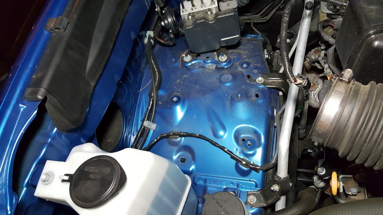

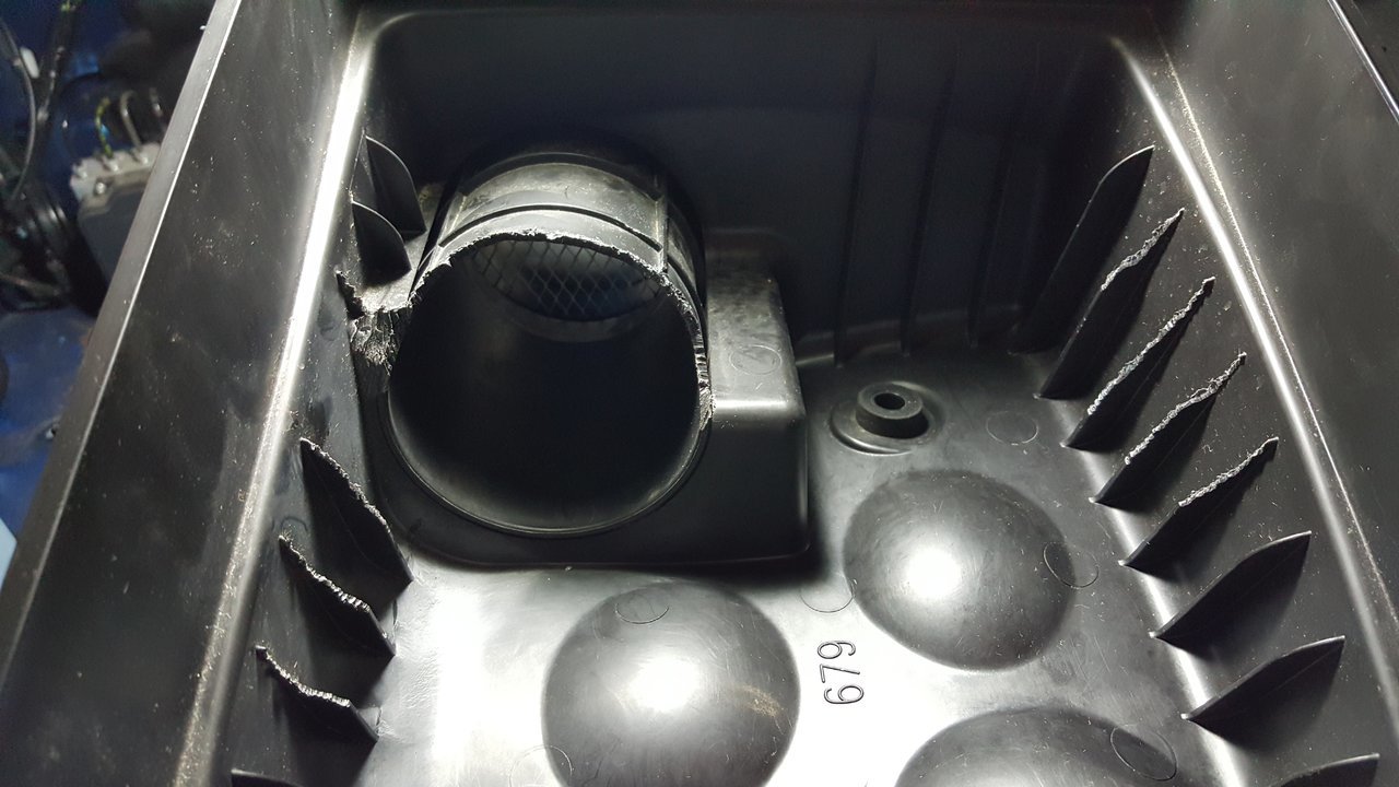

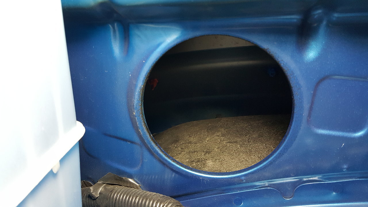

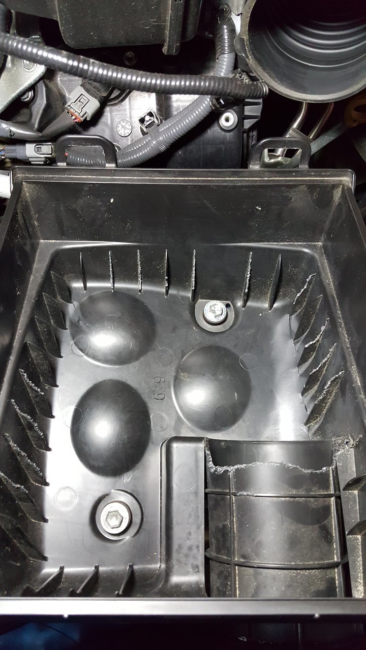

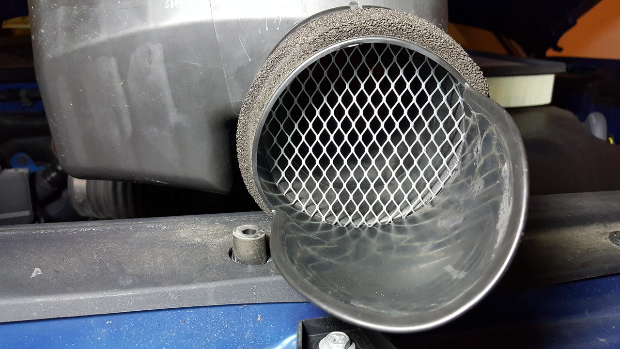

    Hello there to everyone. Just wanted to quickly let everyone know to be very aware that mices are able to get into your factory air intake box this was discovered today when I brought my car to the dealership today they pointed it out to me I will be sharing pictures on how I fixed it and also the damage that they did luckily no harm was done to my engine just a little plastic he end up here and there. What I used to fix it was the top of the old air filter which is almost like a chicken wire. To loosen up the hose of the air intake was a 10 mm and to get the air intake box out of the hood was three. One more thing you will see and one of the photos that you are actually looking at the hole where the intake box actually goes into the filter you can see the covering from the fender from the other side what protects it from any water or dirt splashing back into the back of the fender there are using that plastic cover as a major highway to get into the air filter. Hope this helps out everyone or anyone going through it. Take care and God bless 20171211_134826.jpg 20171211_134844.jpg 20171211_134826.jpg 20171211_134844.jpg 20171211_134908.jpg 20171211_134931.jpg 20171211_135230.jpg 20171211_134826.jpg 12 mm bolts two in the inside of the box and one on the side of the box.
