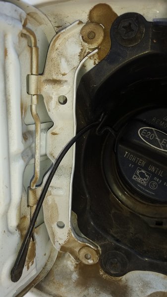

    I'm getting a custom shell done by Tradesman Truck Tops and need a part to color match for the paint. They have the quicksand code but said if I could send them the gas cap cover they could more accurately color match it. What's the best way to remove it?

    Isn't it riveted in place. If so then use a die grinder or a Dremel with a same type of grinder to take the head do the rivet off.
    Edit. Yup. Grind off those 2 heads and should pop off.

    don't grind, Drill. Those look to be big ass rivets.

    Yeah go ahead and grind and make sparks right next to your gas cap, what could go wrong?

    Valid point maybe I'll drill :thumbsup:

    Yes you can drill too just take your time

    Def looks like rivets to me, a drill bit double the center hole size should be sufficient
