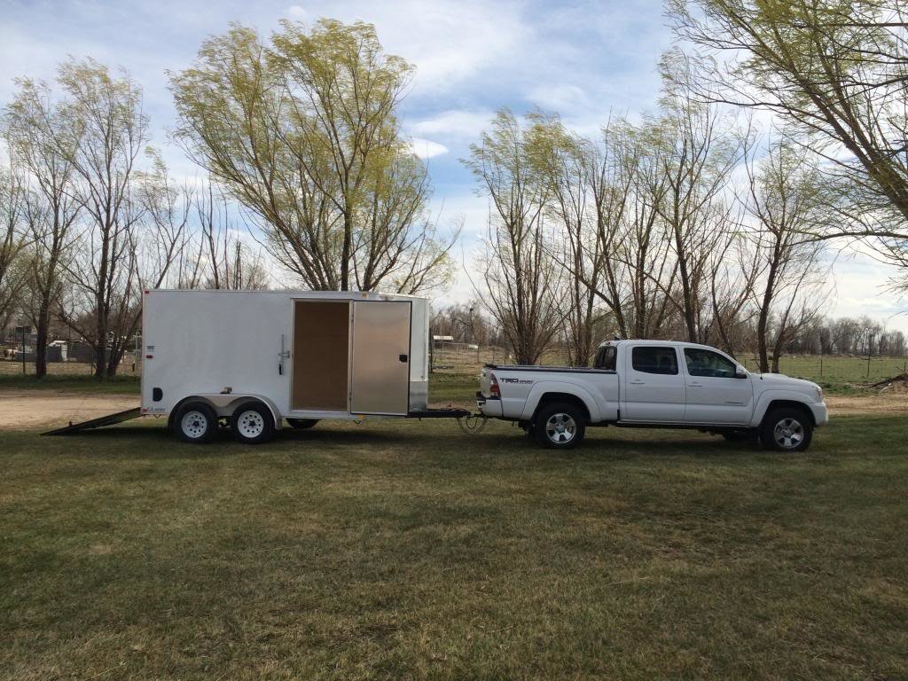

    I ended up w/ and H&H. Very happy.
    Stay away from Lark or anything made in Georgia. Try and stick to brands made in the mid-west.
    My H&H ended up cheaper than a similar Lark. I was like you, looking for a cheap trailer to haul motorcycles around. After a lot of shopping I found a nice dealer w/ H&H. Go bigger as well. move up to at least a 7x12 if not a 7x14. Go dual axle or at least get a single axle w/ brakes. I started w/ a 5x8 thinking it would be great as it would fit in my garage. I kept getting advice to get bigger. Glad I did.
    After reading many threads about trailers and towing, it seems that weight does not affect MPG much. Once you hit a certain weight, the MPGs stay about the same.

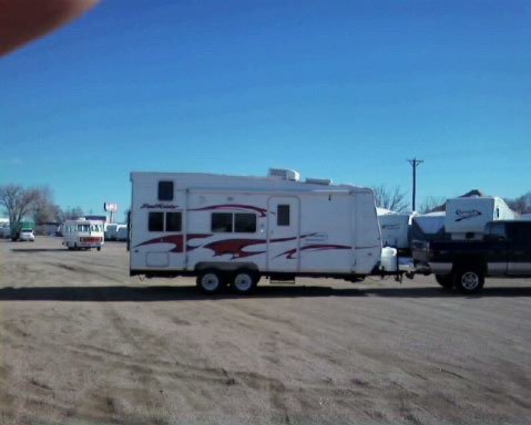

    You don't need torsion axles either. Not needed for the amount of weight you're dealing with. The Toy Hauler I just sold had the same type of axles as my 7x12 cargo and it pulled beautifully at 10,000 lbs.
    Spend money on radial tires and possibly go up a rating as well. Mine came w/ radials and D rated tires. Basically one tire could support the trailer empty and two near max weight rating. Four should be overkill.

    FYI, Mine listed for over $4500 and I ended up paying $4250+ tax and he threw in a matching spare. Flip up jack has proved to be very convenient as well.

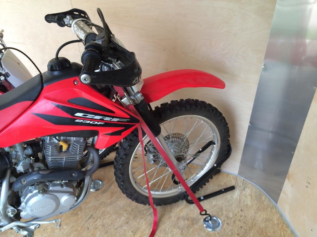

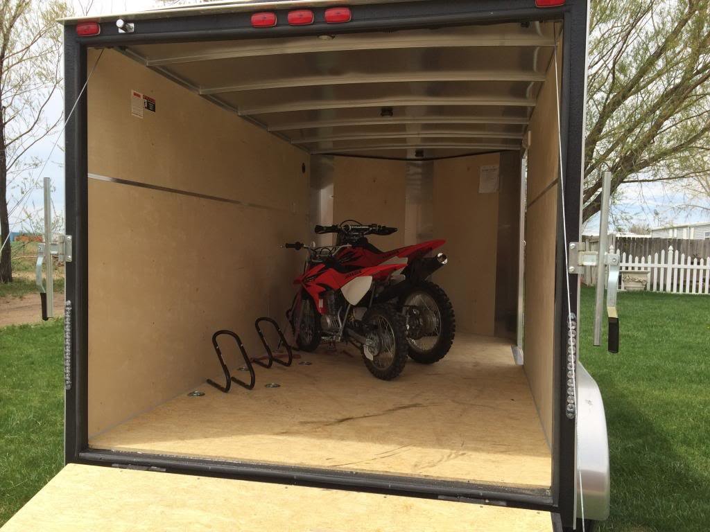

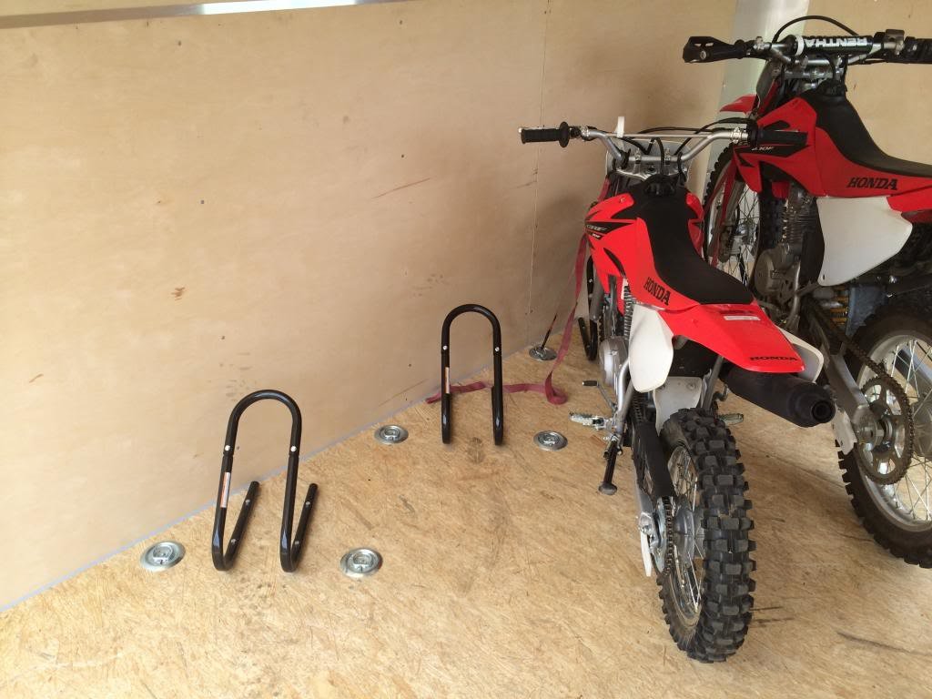

    Go with 7x12. You'll be happy you did. The extra width makes a HUGE difference hauling motorcycles. Although the 12' should make it possible to stack two bikes end to end without staggering.
    This is how I set mine up. I can get the front ones out without removing the rear ones. It's tight, but possible.

    I do have one question for you. With those tie down plates (I'm assuming from Harbor Freight), what did you use to fasten them in? Did you wood screw into the floor or drill through and use bolts with nuts on the underside?
