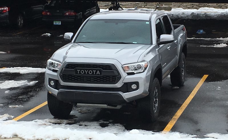

    Hi everyone,
    I'm looking into replacing the stock tires with a set that'd be optimized for overlanding and long highway travels. Stock rims, suspension, no lift. I am a noob in the truck scene and could use good pointers here.
    Here is mine, already running at 5300 miles just past its first payment. Along with tires, it will soon add a Leer cap. image.jpg

    whichever ones you like and get the best deal on. honestly any of the big names should be fine. skip the MTs for lots of highway. it really depends on your terrain. looks like you got some snow so i would probably look at which ATs do well in that.

    What would be the next size upward from the stock trd offroad tires?

    265/75/16 then 275/70/16, some folks run 285's but that's about all you want to do without a lift and may require some fender liner or mud flap removal or trimming
