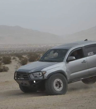

    Im pretty in love with the Fox Pros up front, ride nice on the street and soak up the big hits nice. Peep me jumping to flat lol
