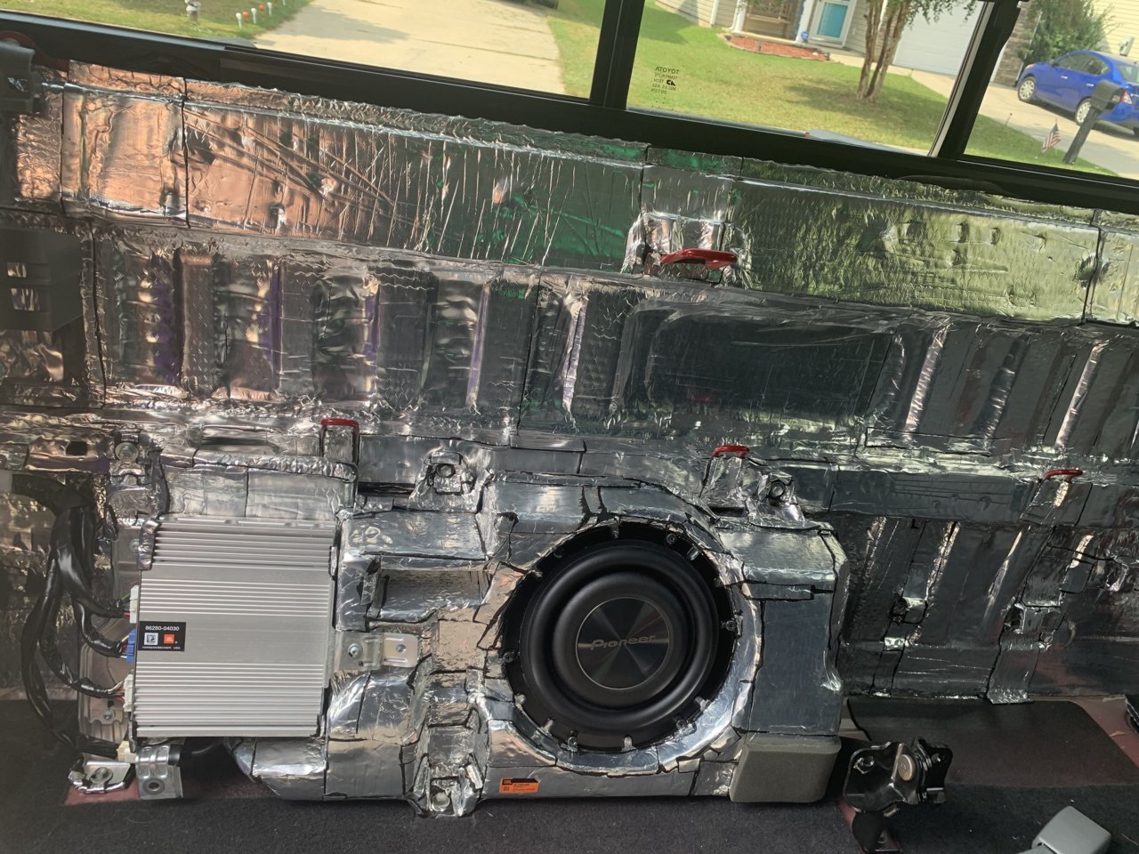

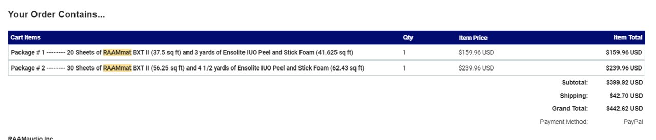

    from 2017, my RAAMmat order for double cab..... the RAAMmat BXT was approx .100" thick with super tacky adhesive... I was happy with the quality, but no matter what you use it will all be expensive....but worth it as it doesn't feel like I am driving in a tin can.....

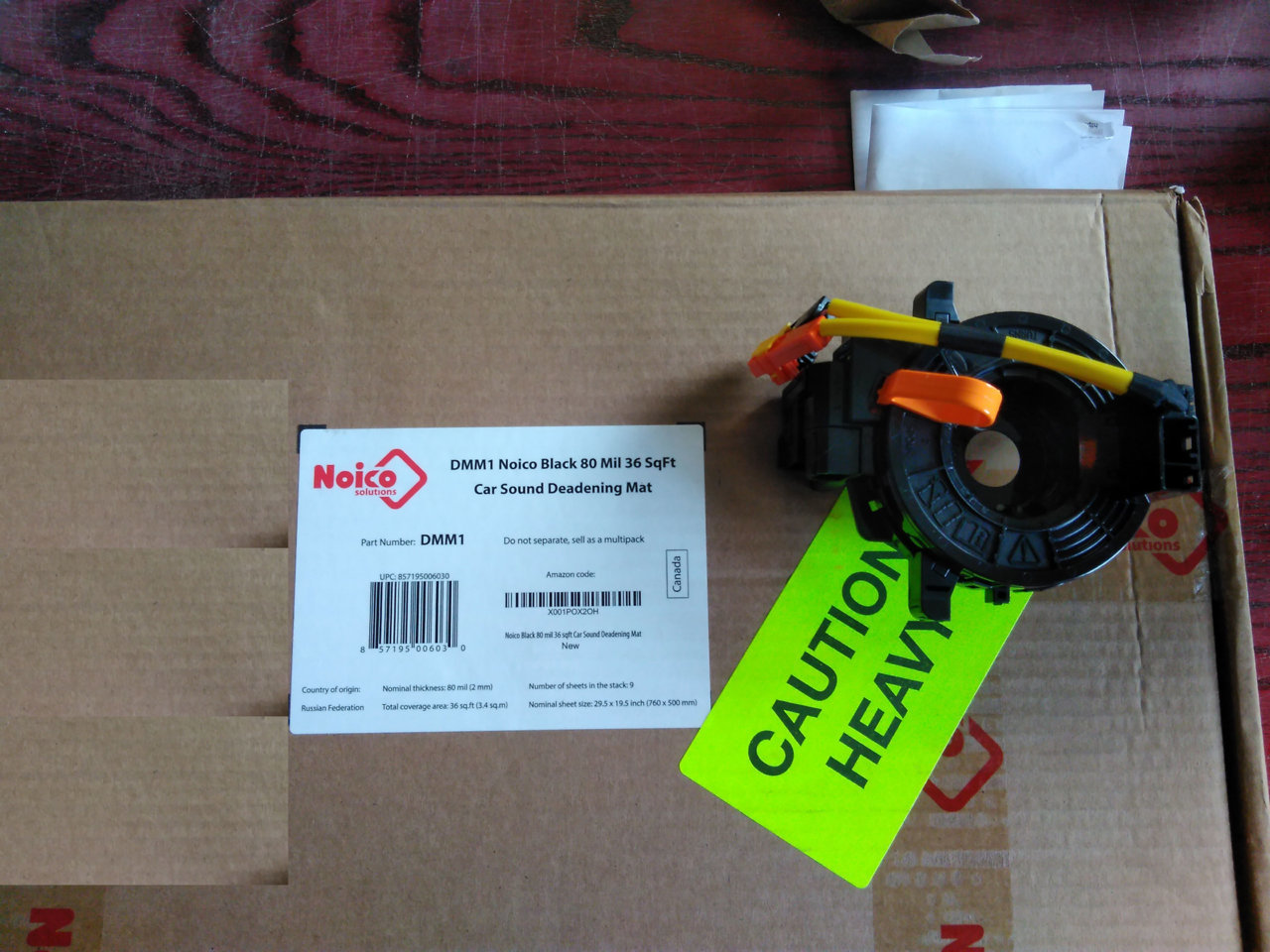

    I found everything I looked at that was quality was expensive. I went with the Noico. It makes a big difference.
    Used it under the shifter assembly area.
    Also started on the back wall. I have found this product to have no smell at all, but you better want it on there forever. It aint coming off. :annoyed:

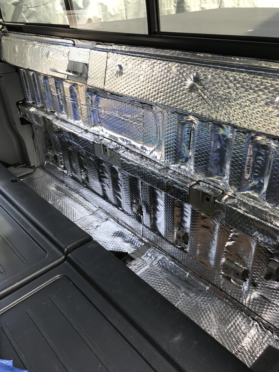

    I aslo bought the noico had more than enough to do the truck
    Noico 80 mil 10 sqft car Sound... https://www.amazon.com/dp/B01KZ5X7KO?ref=ppx_pop_mob_ap_share
    When i did my doors i actually put them inside the door in strips instead of under neath the door card . Made a big difference in quitting down my tire noise. And when when you close the doors it doesn’t have that hollow tinny sound

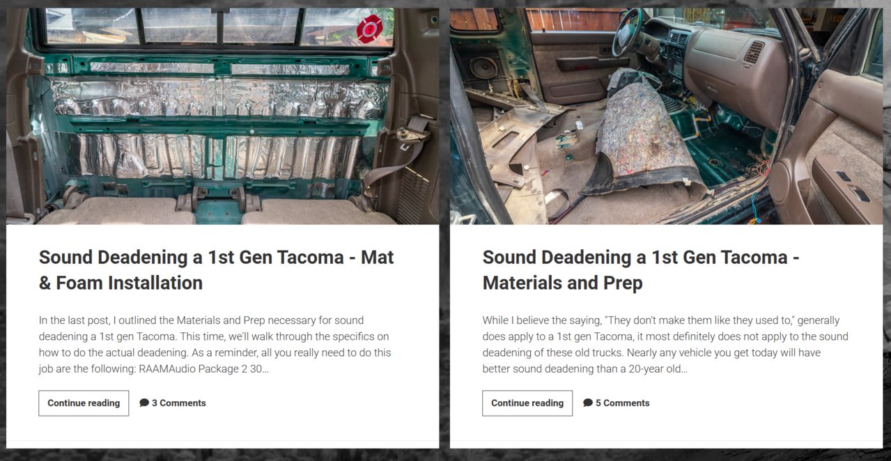

    I did went through all this on my 1st gen. Wrote it all up in a 2-part post. I list several options at various price points, and cover how much you'll need. I assume it'd be similar amounts for second gen.
    Sound Deadening a Tacoma

    I did all of the back wall.rear doors and front doors in strips . When you do yours and you have the doors apart you’ll see that theres like three flat sections obout 8” wide and almost the length of door. Rear floor and storage area was almost full coverage. I did from driver and passenger floor matt area up to firewall . I didn’t do under the seats and didn’t do headliner
