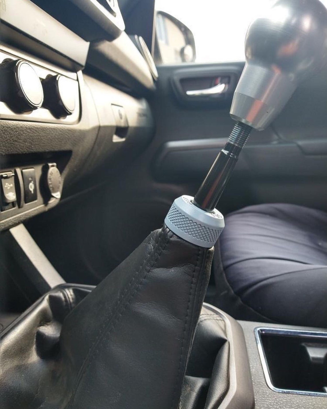

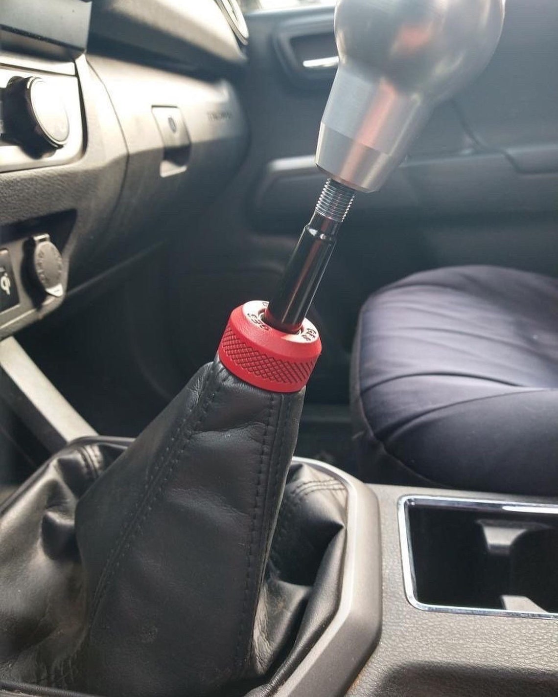

    who here would like to be a Guinea Pig for testing purposes
    and mail a shifter to GES/Gaffney Engineered Solutions,
    or buy their 3rd gen trim (appears the same) $29.99,
    to test fit on your 2nd gen - even better if with AJT Knob
    to see if they fit
    It does look the same...
    Many colors
    CascadeCreekDesign on Etsy
    probably much better than the stock chrome...
    There's also 'Dubbs Hardware' half the price on Amazon, but without knurling
    https://www.amazon.com/Dubbs-Hardwa...ocphy=9031335&hvtargid=pla-1897677676502&th=1
    I'd assume it would fit given 3rd gens are rebadged 2nd gens and people swap RC62(F) into 2nd gen
    https://www.cascadecreekdesigns.com...3HR6ZlgW559ZwroLLXEX65ZdWgYuzyRSKCQsVI&page=2
