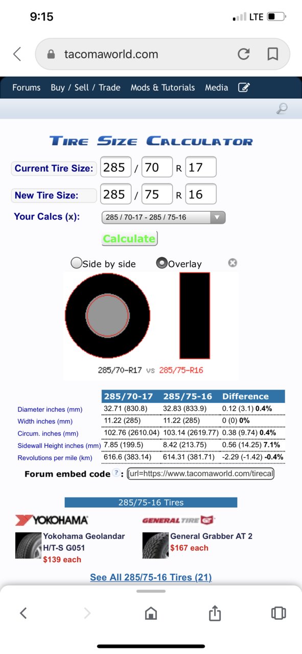

  9. Mar 8, 2020 at 3:30 PM
    Desmon
    Desmon New Member
    Jan 3, 2019
    #277946
    4
    Desmond
    2018 4 door Tacoma
    Tint windows %5 back 35% front with 5 inch eyebrow on windshield also 5%
    I think this would work. Let me know. I’m keeping my original rim
