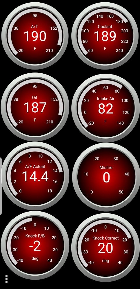

    Using OBD Fusion with the Kitbest OBD scanner.
    OBD Fusion tips and tricks

    The kitbest is bluetooth and OBD Fusion is from the google play store but I've believe there are other apps/scanners for IOS.
