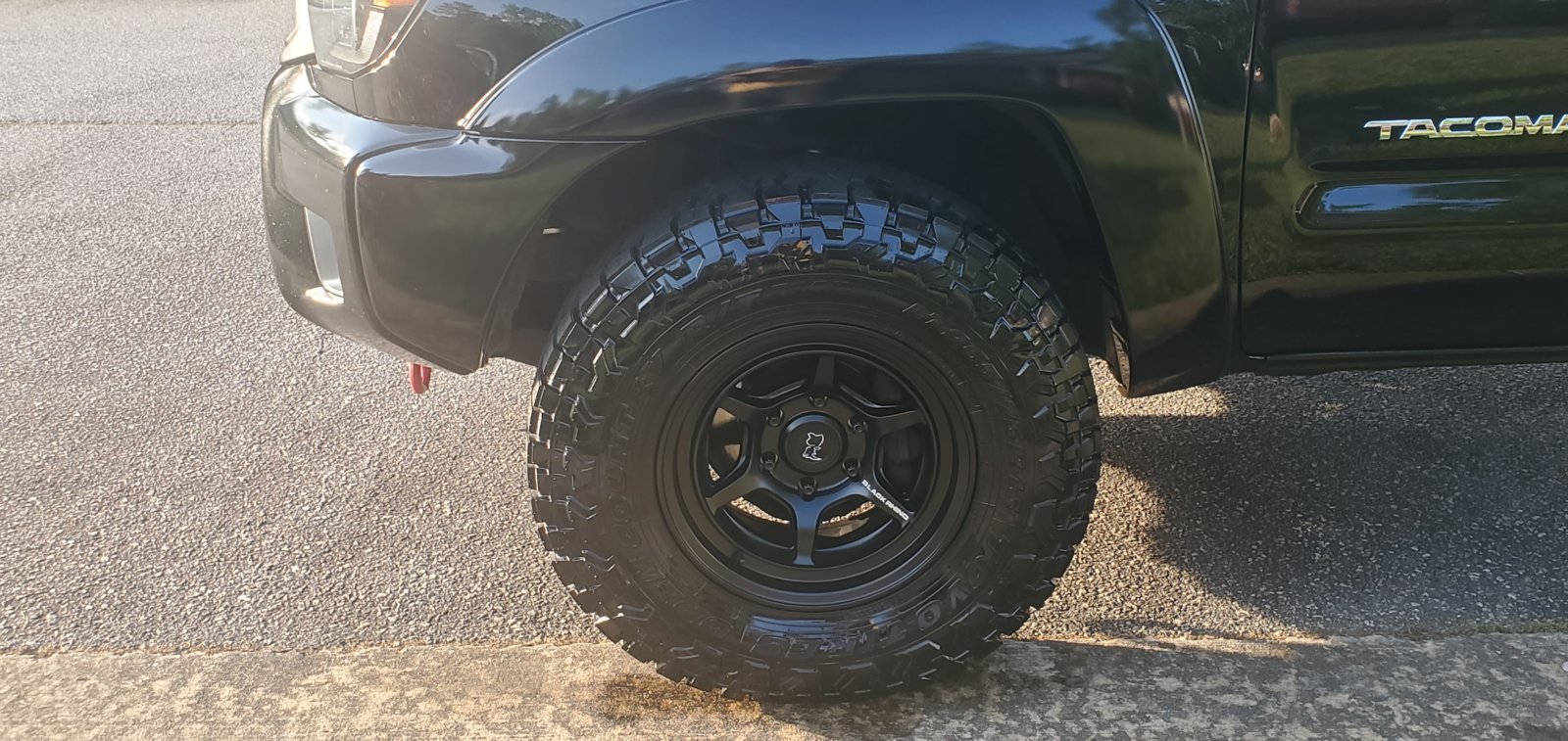

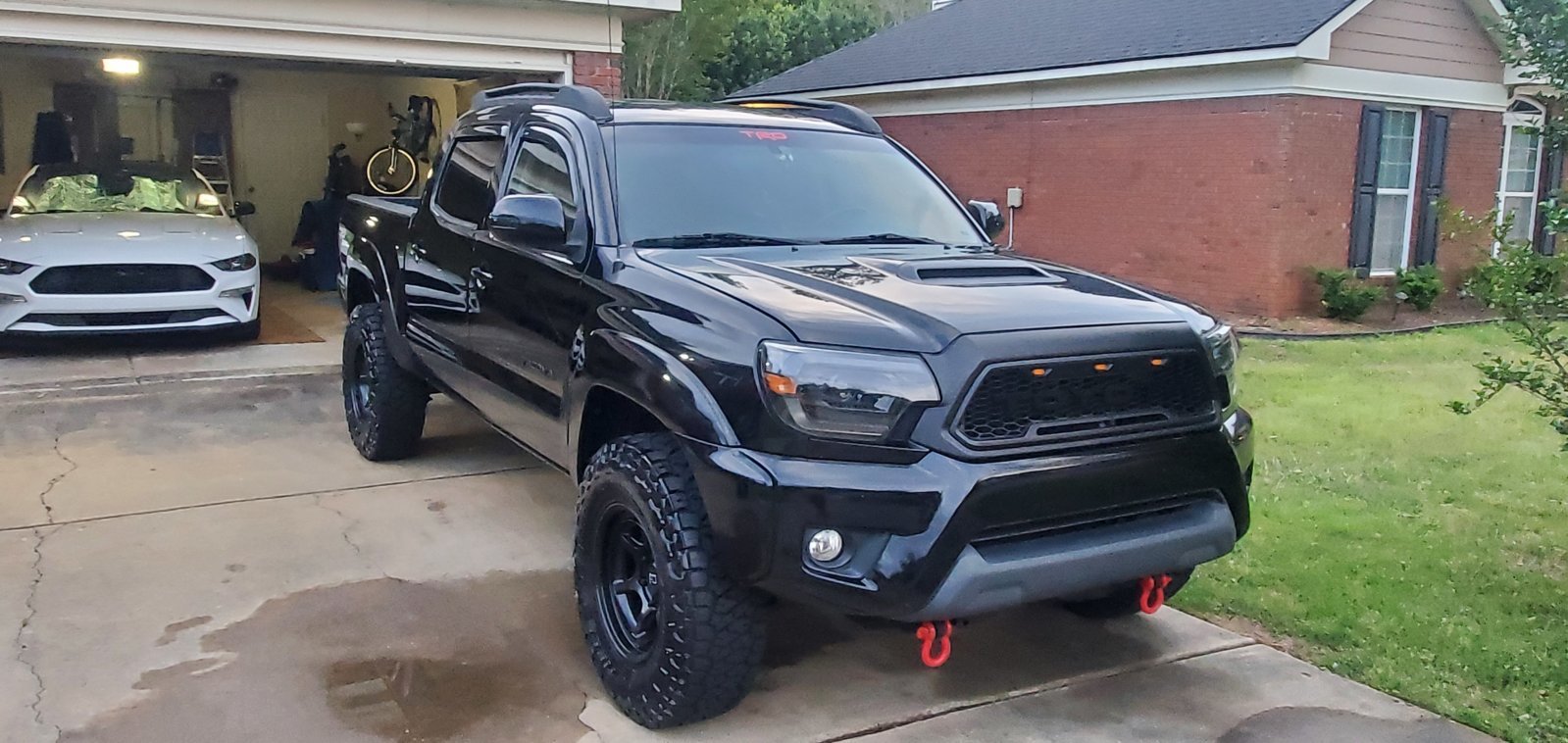

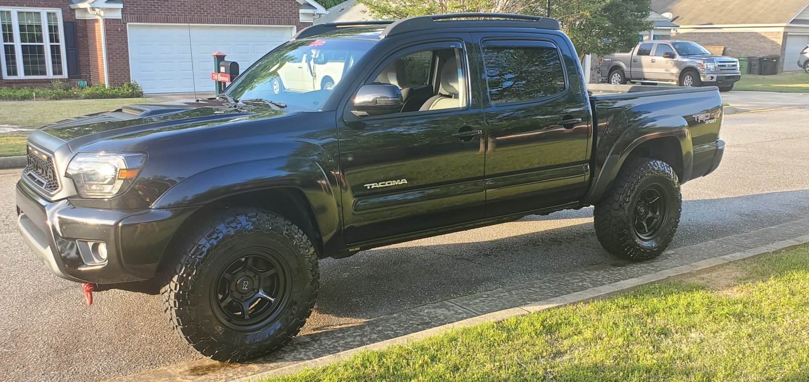

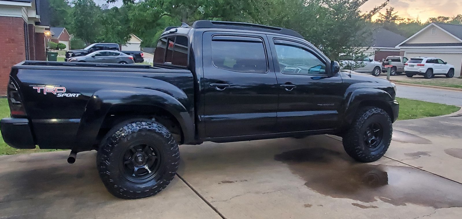

  12. Apr 23, 2024 at 6:04 PM
    Vinchez78
    Vinchez78 Well-Known Member
    Aug 7, 2020
    #336946
    209
    Alvin
    Black Taco TRD sport
    Loving the stance on your truck, I'm looking to do something similar, I just had 265/75/r16 toyo open country rt trails installed on my 2012 tacoma and was thinking maybe a slight lift in the front like yours, looks awesome
