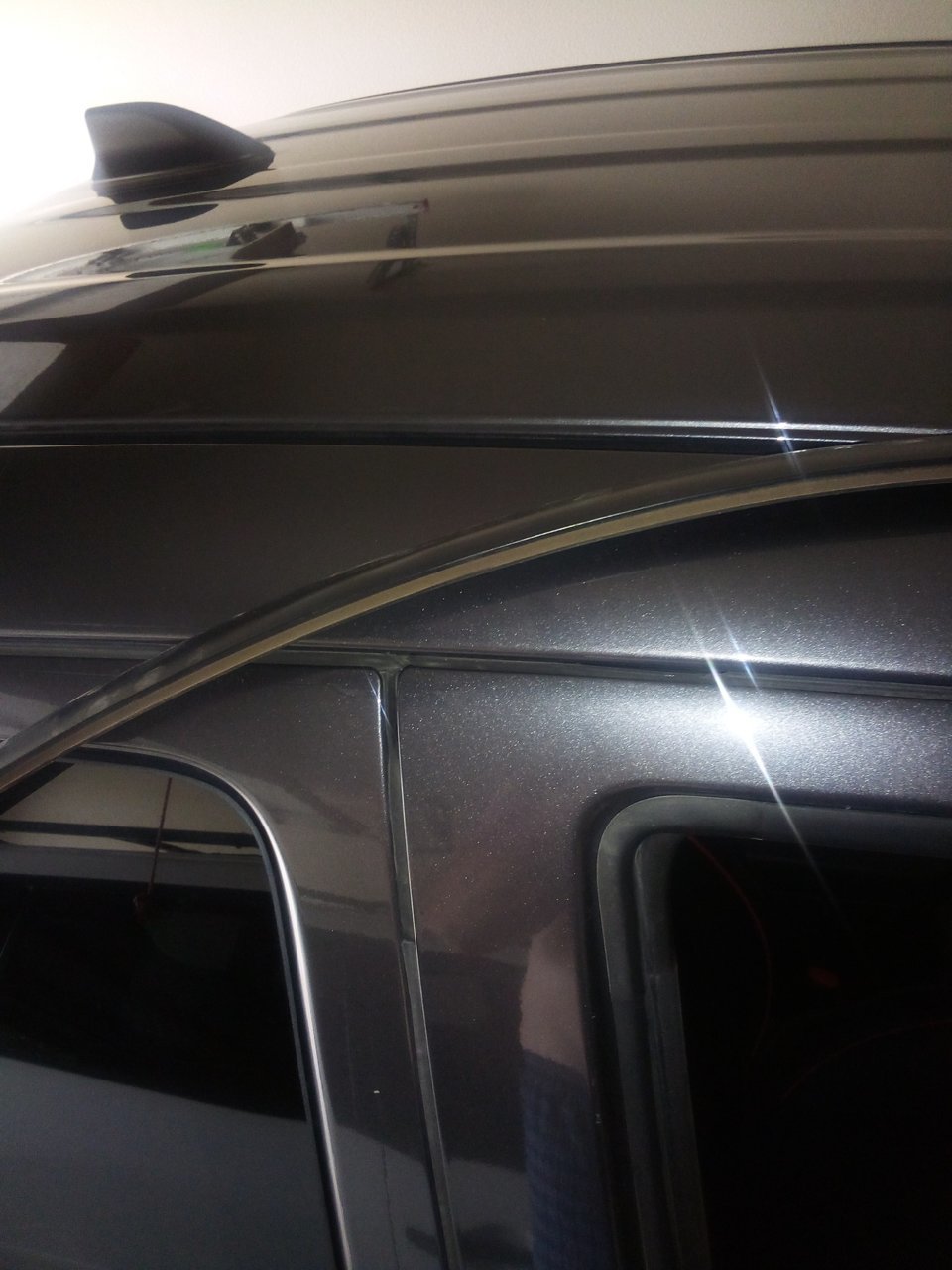

    This happens every time I run her through the car wash....IMG_20230517_185637.jpg

    Heavy Duty double sided 3M tape

    Windshield installer glued my down on a 2018 with the caulk he uses for windshield installs. Never came off and I take my vehicle to full service car washes once or twice a week.

    I used gorilla glue to keep mine down.Double sided tape did not work for me.

    The problem I had was, the rubber strip doesn’t go deep enough in the metal channel to touch one layer of double sided tape. I didn’t want to do it this way, but was pressed for time, and stacked a few layers tall (made about 4 squares for each side). It’s held for a couple of years, so I haven’t gone to my next try; some type of silicone or whatever paste in a tube. That way I could fill the void (maybe in a several spots) and still be able to remove if it ever needed to be.

    "clips" yeah, they dont hold very well. I glued the clips then duct taped the trim down until it was cured.

    No it seems the factory design was a little bit of friction, and primarily relies on gravity.

    The glue worked the best for me. I put a couple of daps along the track, let it cure over night. I have no intentions of ever pulling the rubber strips up so that is why I used the glue.

    3M Rubber and Gasket adhesive.

    There are clips at the front and rear but, they dont hold well. windshield urethane sealant will hold, for a very long time. just be warned... it is like anti-seize, and it gets on everything, everywhere, no matter how clean and careful you are. it only cleans up with solvents. do not get it on cloth interior, or any clothing you really like. it will not come out, ever. Ski

    one day out of the blue, one of mine flew off...I just happened to hear it fluttering before it went airborne. I picked it up and put it back and it hasn't gone anywhere since.

    Maybe 3m weatherstrip and gasket adhesive. Not sure if that's any different than the 3m mentioned above though.

    I used clear silicone caulk.

    Happened on my gen 2. I used Liquid Nails and never had a problem thereafter. Have not seen problem yet on my Gen 3.

    it seems to be the cross winds from the carwash blowers, and mine (and I think others) didn't start until the truck was about a year old, they seem to barely hang on for a bit.
