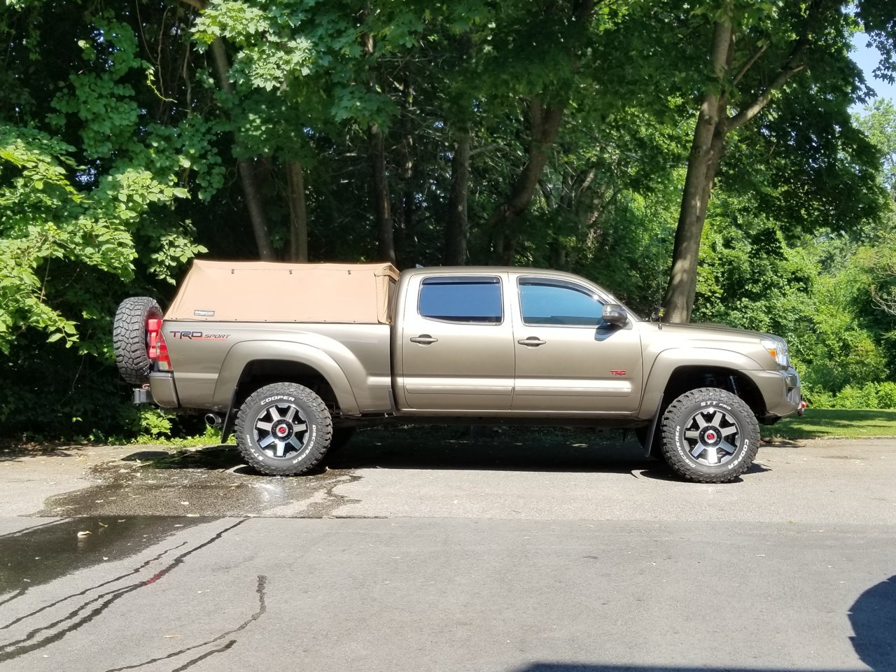

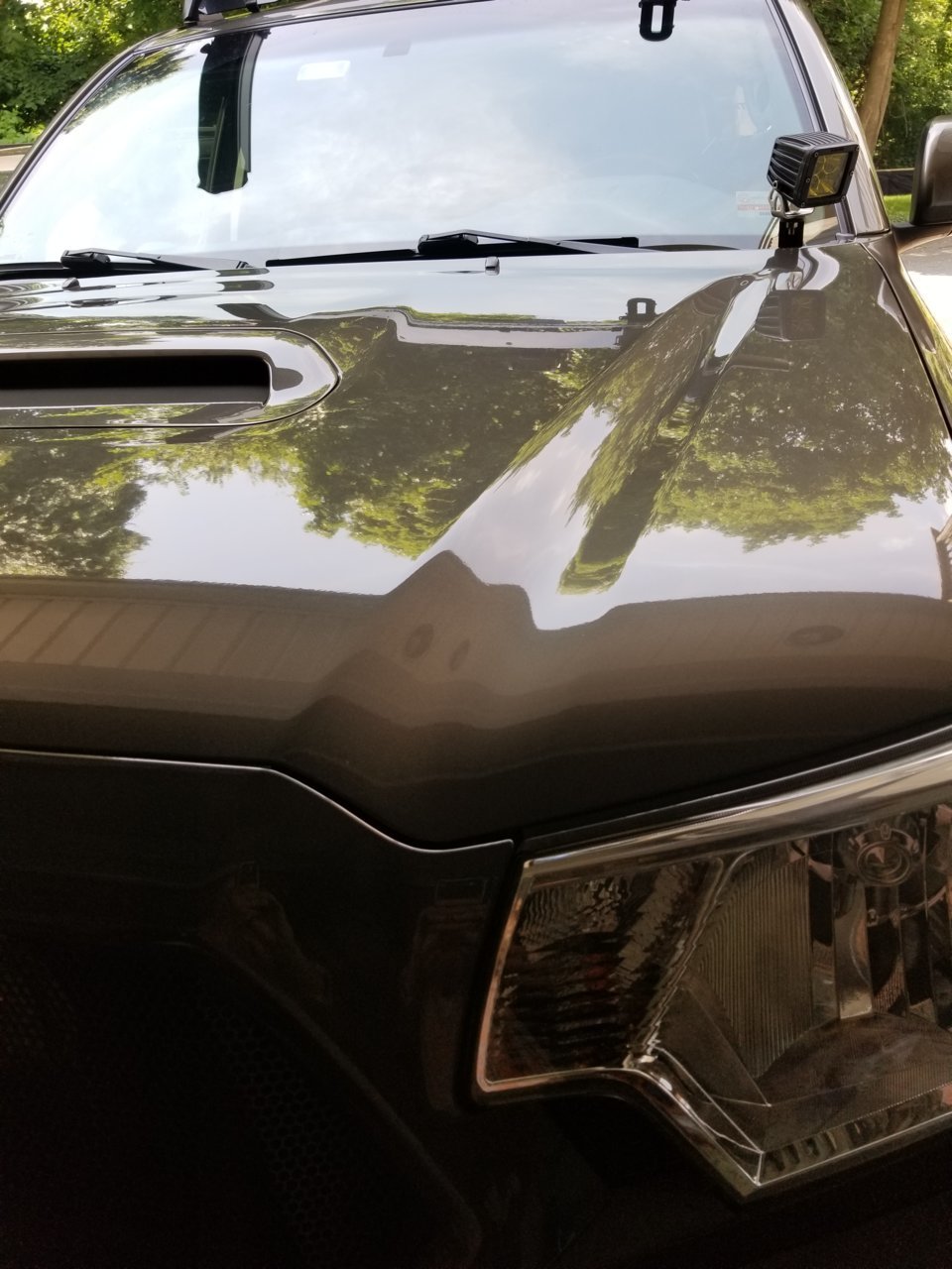

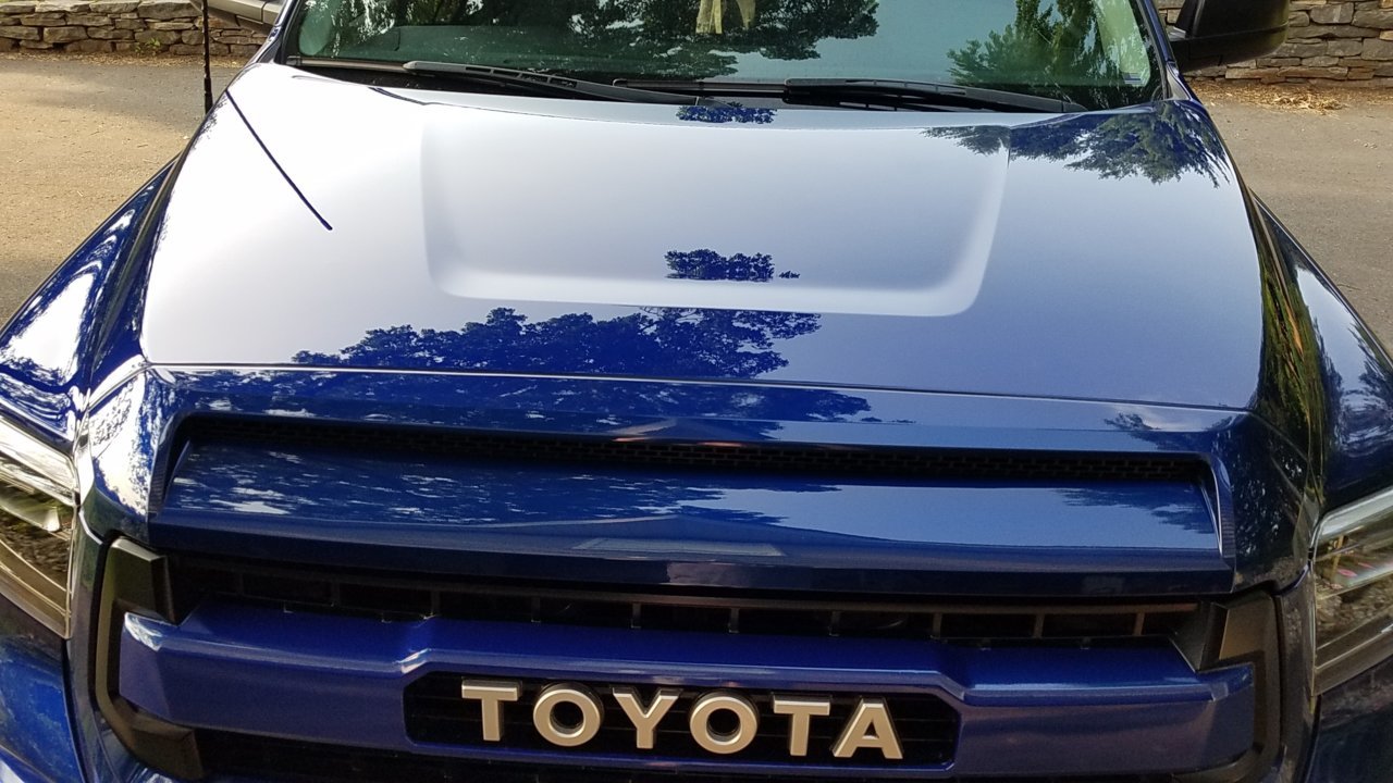

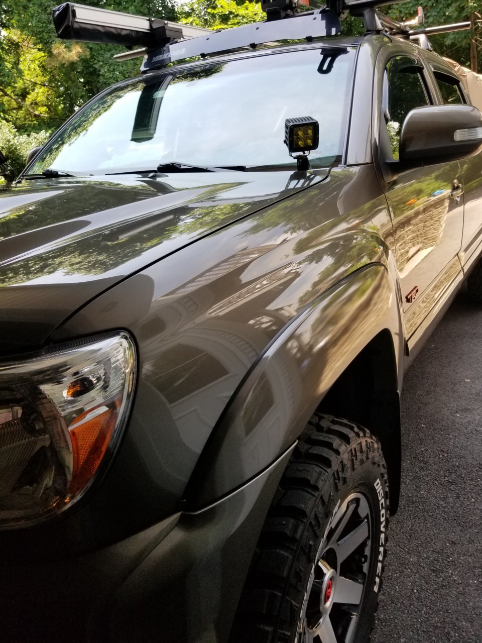

    Finished cutting and buffing. It will get DPC shield ceramic (figured I would start easy and cheap for my first try but now wishing I got cquartz). them carpro hydro2 and reload followed by beadmaker. These pics are after finishing up with carpro clear cut and then essence. Good stuff.

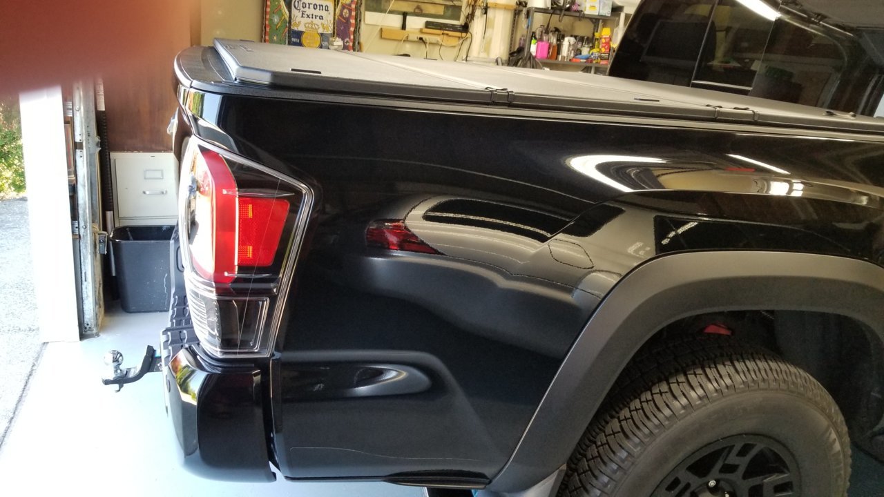

    20190721_160704.jpg 20190721_160720.jpg 20190721_160915.jpg 20190721_160804.jpg 20190721_160915.jpg
    did carpro cq.uk 3.0
    6 months ago after
    bead maker
    Yesterday
