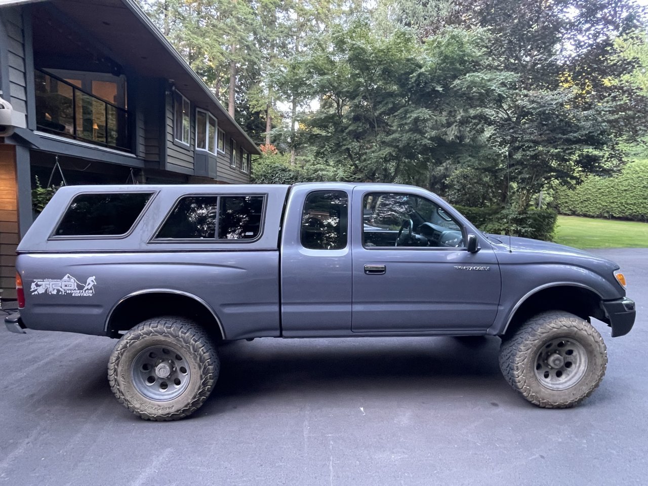

    Summer is coming to a close and it's about that time to clean the undercarriage and put on a fresh new coat of Fluid Film. I applied FF last summer on all the suspension and frame components; and now there is a years worth of dirt and grime stuck to the frame. What is the best de-greaser to remove all of this shit before I put on a fresh new coat? I'd like something highlight concentrated that does most of the work itself so I don't have to scrub anything, and will rinse off. Bonus points if it's biodegradable and safe on rubber & plastic. Cheers!
