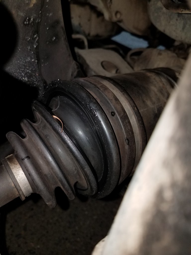

    Hey guys I have a 2002 tacoma 4x with 2.5 OME lift kit I also installed the 1" diff drop and I am going threw cv boots like crazy!!! the angle of the shaft causes the ribs of the boot to rub onto each other and disintegrate I have ran napa cv and now orileys auto parts cv does anyone know of a cv shaft that has more of a v style boot ? Or is this just the name of the game with lifting......

    OEM cv's, they have better travel than the auto part store brands.
    There are a few brands that offer high angle cv boots, too. Like All Pro, they make some specifically for "long travel" which should be more than enough.
