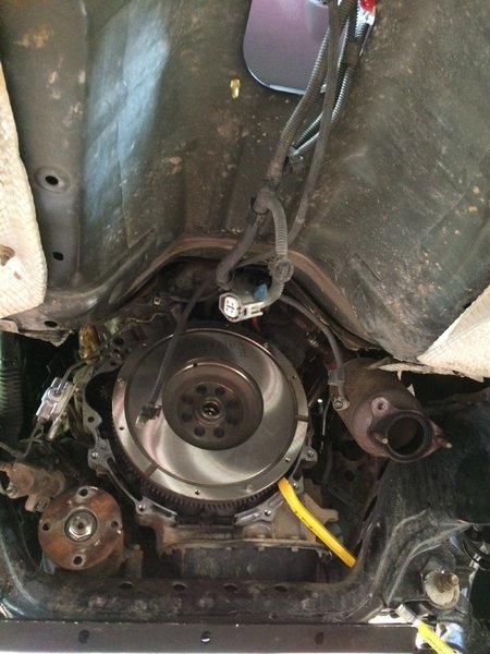

    I’ve got a URD heavy flywheel that came with the bolts for them from URD, and a stage 3 clutch from URD. Paired with the CM hydro bearing. It’s a nice setup compared to the factory junk.

    Between the bird chirp and the poor gripping it just didn't tickle my fancy. My truck only had around 50k miles on it, I know how to drive stick been doing it for 20+ years, and I've never driven such a shitty OEM clutch/slave cyl setup my whole life. Upon removal the clutch had plenty of life left, but the flywheel was glazed over and so was the pressure plate. I bought my truck with 10k miles so I doubt it happened from the previous owner. Years of heavy wheeling (NOT clutch burning) must have taken its toll. I did the job myself so I know it was done right. Haven't had any problems. I've done a few swaps for folks and never had any complaints, so I'm guessing those that did had a shitty mechanic do the work or just had bad luck, but URD should make good for it if that's the case. I like the extra rolling torque you get with the heavy flywheel, it's great for offroading. If you have tall gears, it may not be for you as it will take a little more feathering to get it going. I have 4.56s and two transfer cases so I rarely run into a spot where having to start that extra weight from the flywheel is noticeable.
    On the new setup, the shifts are smoother, the grip and snappiness is just there compared to the old setup, and also that bird chirp is long gone

    To be honest I just went with what I thought would be best for me. The stage 2 has carbon/Kevlar on both sides and the stage 3+ has segmented ceramic friction on both sides and said good to use for forced induction which I don't plan on going that route. The stage 3 is a hybrid of that with a dual friction assembly.
    The description seemed to fit what I was looking to get out of it as well, "The URD Stage 3 clutch assembly is rated for 500 wheel torque combined with very streetable engagement with only a slight increase in pedal effort. If you are looking for the best step up from the stock clutch, this is the one for you."
