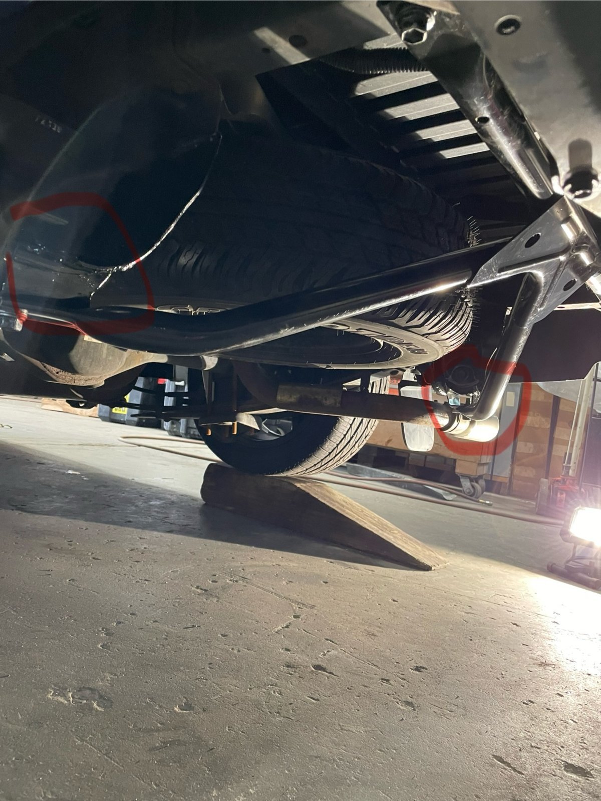

    Yes bilstein 4600 in the front and qa1 in the back, truck is riding so smooth now. I should’ve done this sooner. I also removed the xbrace.

    Awesome! Are you running x runner springs up front?
    Any chance your selling that x brace?

    No just regular springs. Possibly, where are you located? Shipping would be a pia but possible.
    You would also need the shackle mounts welded on to attach brace.
    The shackle mounts part numbers are 51268-04030 and 51267-04020.
    Are you interested in the xrunner shocks also? I have a set of those too.

    I’m in Rhode Island but I may pass on that brace. I forgot it needed welding… did you feel a big difference with and without it?
    As far as the shocks go I’d like to get new or very close to it.
    I was also looking for the x runner springs but it seems like you got good results running the stock springs.
